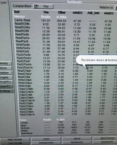

The A3640 has to access the motherboard ram or z3 ram and both are considerably slower than local ram on a cpu card like the Cyberstorm or GVP or Warpengine. As an example, whilst my 50mhz 060 Cyberstorm Mk2 gives about 66 MIPS and my 64mhz 060 A3640 returns 85MIPS, both Doom and Quake run noticeably faster on the Cyberstorm despite the slower clock due to the faster ram access. Memory access speed on the A3640 with 2 wait states removed is in the region of 15-16MB/s whereas of the lower clocked Cyberstorm is about double that.

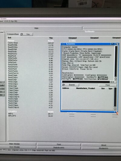

Here are the Sysspeed results for an A3640 with 64Mhz 060 and the machine state mod to remove 2 waitstates. This improves memory access by about 20% over a stock A3640
The following pic shows the Cyberstorm mk2 50mhz, a blizzard 1260 80mhz, a 25mhz 040 on an a3640 with the waitstate mod, a stock A4000 040 25mhz
