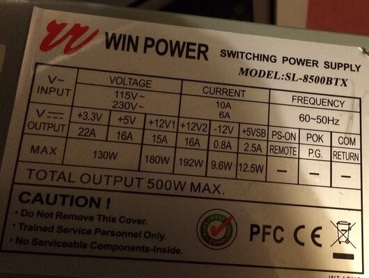

The power supply is upgraded as the original that came with the tower couldn't power the 060, i've attached a picture of the rating sticker to this post. Could this all be down to the power supply being inadequate again? If not what else could be the problem? I can't remove the 060 to test the Mediator as it requires fast ram at least to work so i'm a bit stumped as to what to do next.

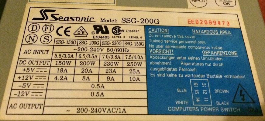

I'm not sure if this could be power related (sorry I do not have any pictures of the A4000 PSU ratings at hand), any ideas on this one?
