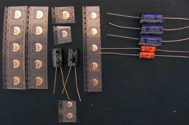

now why didn't I think of this. I have photos of all the A4000D caps, just not all in one picture.. I can add that the A3640 needs 5 new 22 uF 16V as well..
Photo of a recap set as per rkauer's post, also including caps for a rev B daughterboard.
Daughterboard caps:
3 x 220 uF 16V
2 x 22 uF 16V

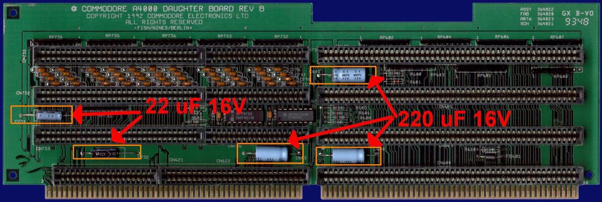

Hm, do you have something similar in your mind? :p
For the daughterboard? It's only five caps and they're easily spotted so I don't think any "map" is really needed, but since you asked...
No, I didn't say anything about a daughterboard. :roll:
Well you said "something similar" and the main subject is a capacitors map of the mainboard... so that's the natural inference. What were you referring to, if not the daughterboard?
