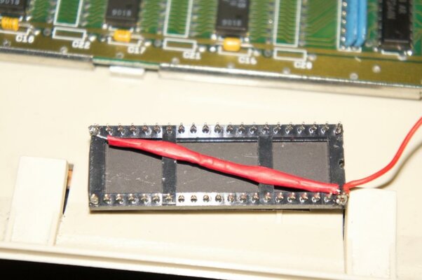

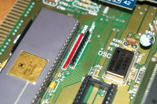

Hi again my friends :)
I've :Doh: to publish some pics :)

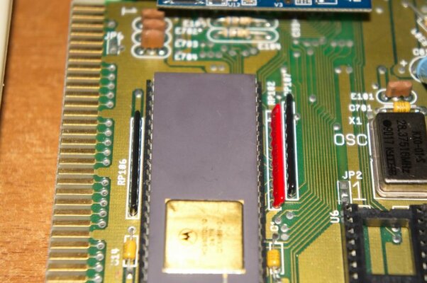

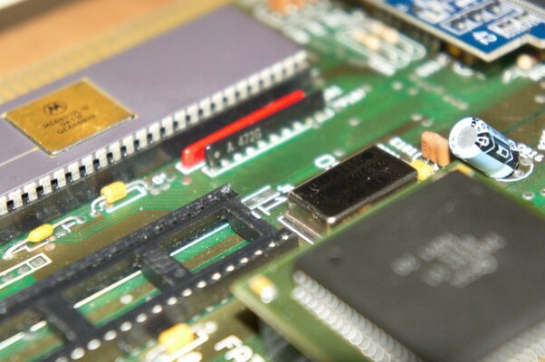

First the SIL 4K7 resistors:
The 42 pin socket with 4K7 resistor -isolated- from pin1 to pin22:
To be continued....... :)
More pics :)

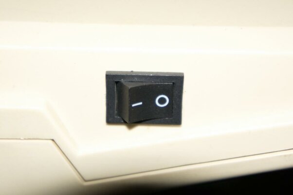

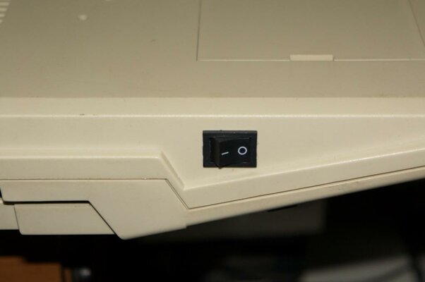

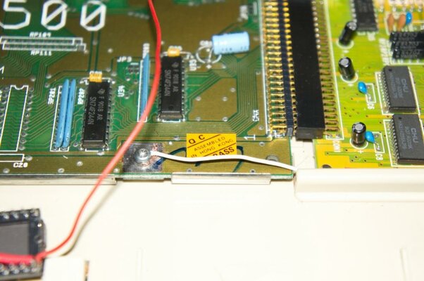

Switch connections...
An external view of the switch

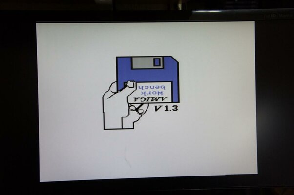

And two screenshots:
And that's all....for the moment.... :lol:
