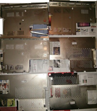

Hi Amiga Fans,

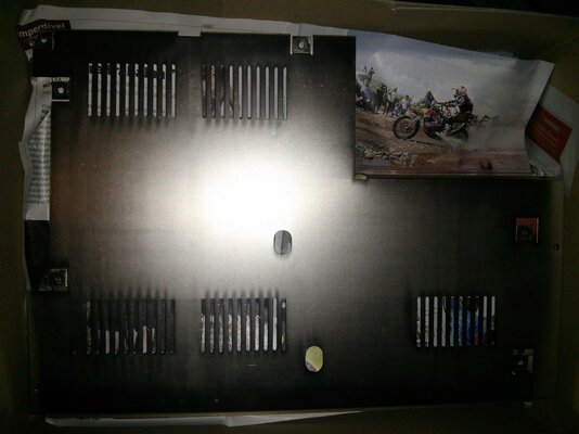

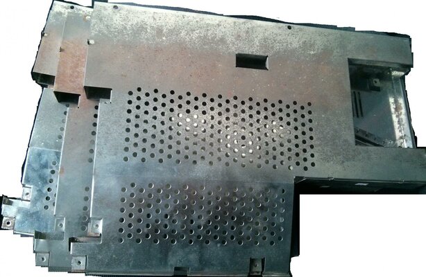

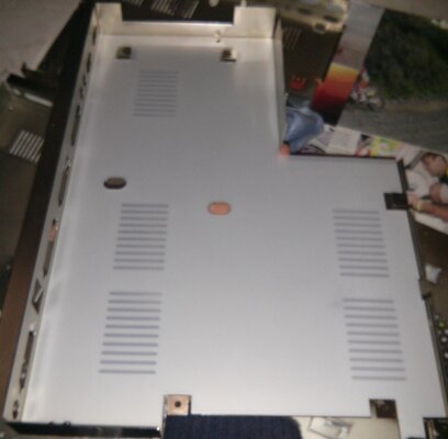

This its my project to restoration of a 3 Amiga's 500.
There is the 1st couples of pictures. Will post more when trough the project.
This its the state of the shields (I didn't take more pics :():
After metal work (that box bring some good surprise:
IMG_20150223_190016.jpg IMG_20150223_190036.jpg IMG_20150223_190057.jpg IMG_20150223_190358.jpg IMG_20150223_190431.jpg
(missing one of that small shield to cover the Zorro / External expansion, if someone have any to sell or know any company who can make one, please PM me.

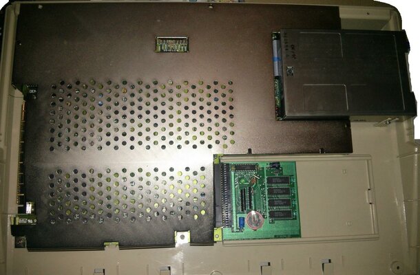

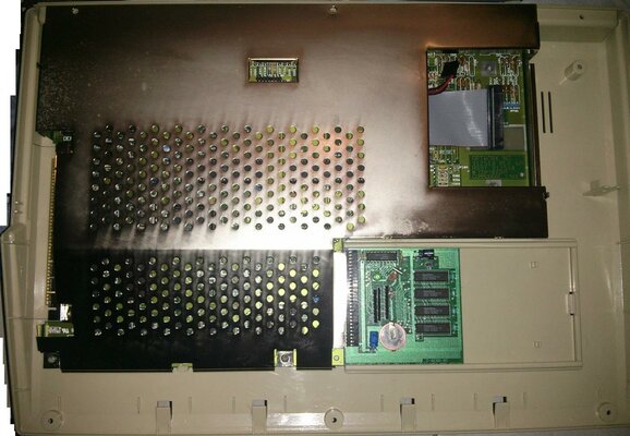

Ram expansion:
How it was,
Some progress:
(this its another ram expansion I have to repair, on the next pictures I fit one ram expansion it's in good condition bought from user Chapas)
The assembly:
To be continued :)

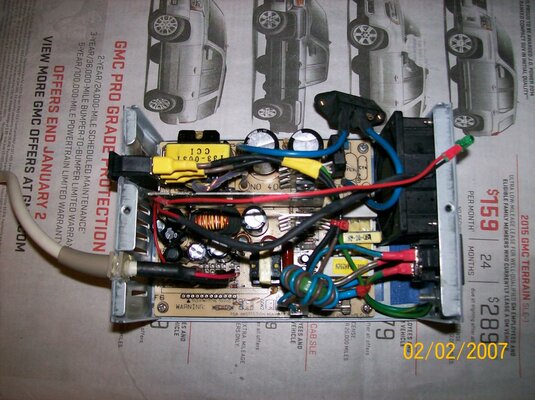

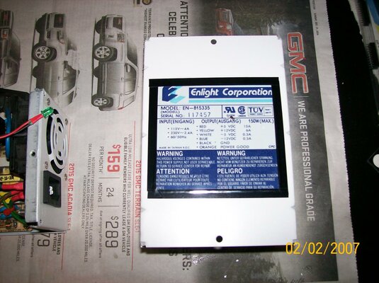

You need to make a PSU unit like this my friend. +5v 15 amp, +12 6 amp, -12 .03 amp. Total output is 150 watts...Plenty enough for all the Amiga add-ons too.. (I have converted 2 of these AT PSU so far)
Oh, in my 500+. I have mostly have Tantalum caps. Except for the three 330uf ones....
Humm nice, I have spares AT and ATX PSU's but I can't find the special Amiga connector. I don't want to destroy an Amiga PSU to get the connector.
Anyone knows here I can find it?

Today I receive the shield form great Roy_bates , I didn't take a picture but fit like a glove.

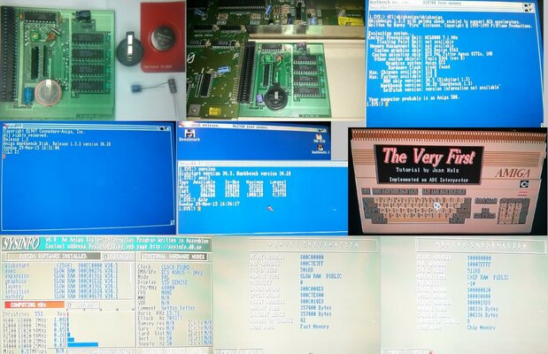

About the ram exp, unfortunately I don't have good news, after replacing the components, except the ram and clock chip (RTC), still don't work / recognized.
Plus freezes the system after a couple seconds of turn the machine on, I only can see the Kickstart image and then grey screen.
I'm think to start making a new exp from scratch base on 501 schematics.
New update:

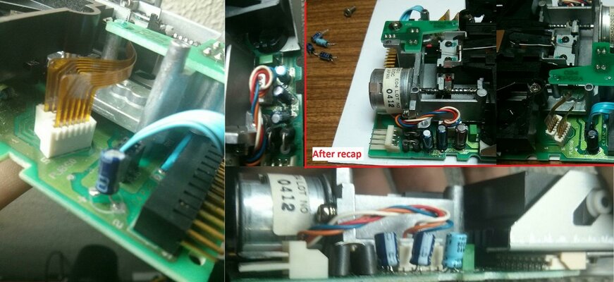

recap on a Chinon FB-354:
recap and battery change on a 500 mem exp. and made some tests:
I'll update with more photos soon as I can :)
