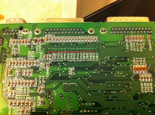

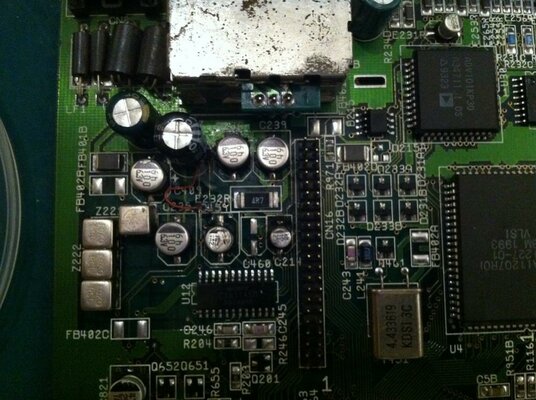

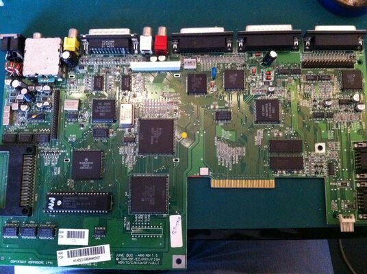

@ BrooksterMax
your board is re capped and running fine , however due to leakage two traces are damaged... but repaired and working now.
clean up and test required.
mike.
http://youtu.be/NEOkPv31OEQ

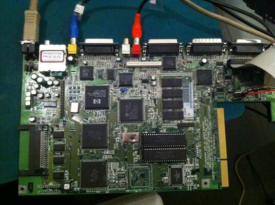

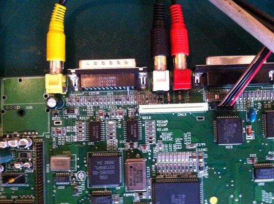

@torm3nt8r
escom / commodore 1200 recapped and tested for 12hrs - no issues found. (would not run longer that five mins before crashing / reboot)
floppy bridge repaired as requested.
ready for posting back tomorrow.

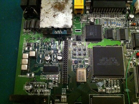

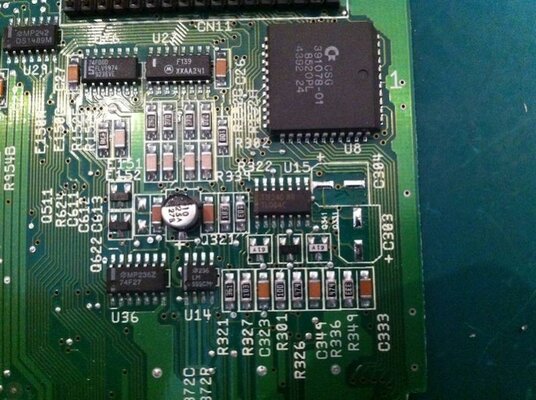

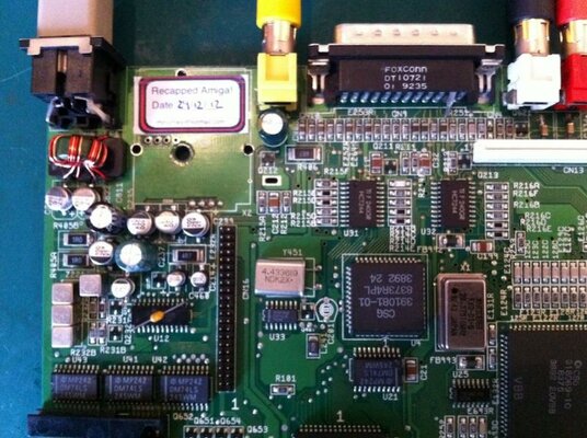

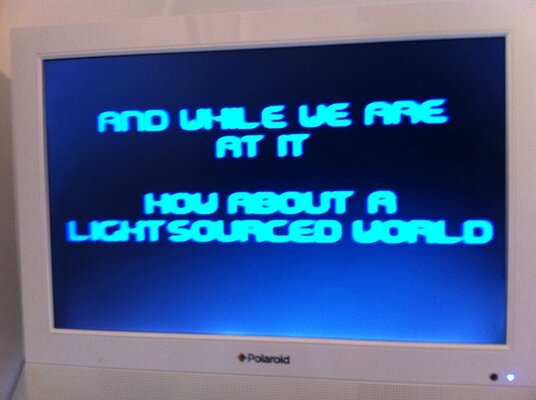

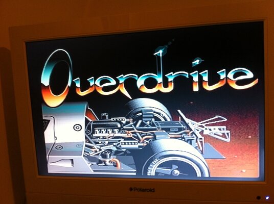

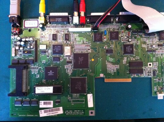

@fitzsteve
A600 & damaged A1200 repaired and recapped. playing with the dead A1200 at the min.
A600 pics below with modulator removed as requested.
ceramic audio caps fitted as standard now on all recapped boards.
http://youtu.be/UwJhQ5BMmtM
quick vid
