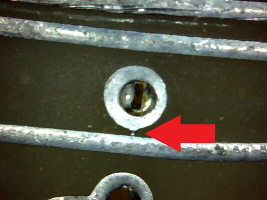

Hi Guys,
regarding the PCB error on the Pegasus boards, here's a picture of where it was and a picture from under my microscope of the actual unwanted bridge.
(For others who might also have one of these NOS Pegasus boards they intend to build. Beware, there are manufacturing mistakes on some of the close tracks. Do a good visual check before you start filling the PCB with components!)

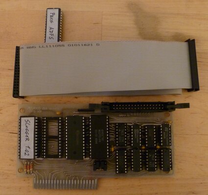

All finished and tested. Here's what's going in tomorrows post...
Bryce.
Parcel went out this morning... I threw in an Acorn formatted DD disk to test your setup when it arrives.
Bryce.
