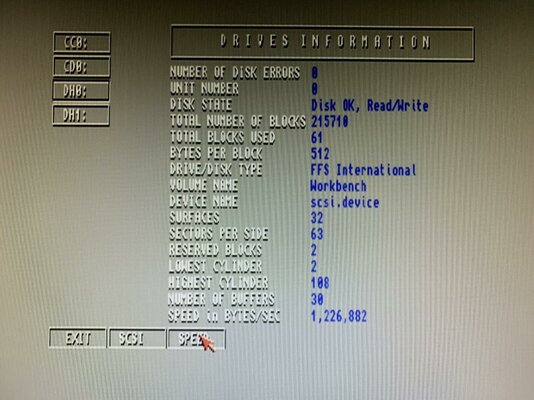

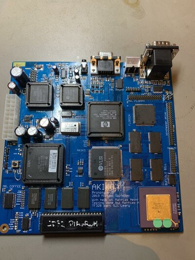

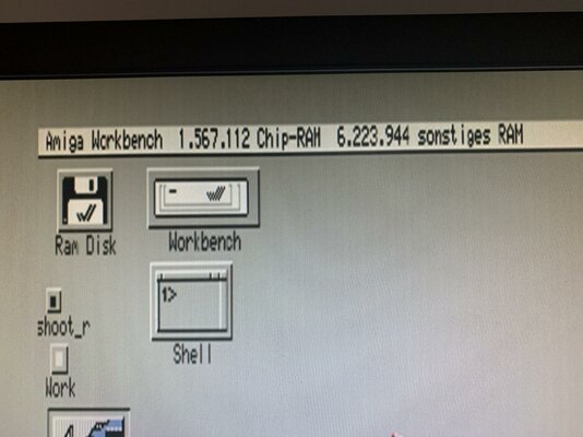

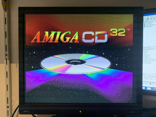

I received the new proto boards a few weeks ago, sourced parts and on 24.12. I got it to start with the Diagrom (what would I do without it? ❤️) and later even to the Kickstart animation. Today, I was able to reactivate the IDE and the Fastram ist now working properly.
There is still lot's of work to do:
- The board does not yet come up without a manual reset after power up
- CIAs and I don't like each other (yet)
- ATMega part is missing (and doesn't have any priority atm)
- Clockports and I2C not tested
I've done the first tests with an Indivision AGA, but with attached IDE cable, the Indivision looses contact to Lisa. I have also ordered some 15kHz board to get some image until the planned flickerfixer is working (um, I mean designed).
And yes, @m0c you should be able to use a GBA TK with it. It will need some firmware tweaks, but it should work. At least, it will fit physically, but I might design a smaller board for the 060. There is also an additional power header near the 030 socket where a turboboard can get 5V and 3.3V so there would be no need for any power regulators on the board itself.

I've still problems with the CIAs. Everything else seems to work. If I disable the CIA access, board boots and is stable. In order to get the CIAs working, I need to emulate the 6800 bus protocol and keep the Akiko IC from the bus as there is a "register overlap" (Akiko does, what is needed on CD32 and would be done with the CIAs in other Amigas like timers, mouse buttons).
I might need some additional wiring as there is on the CD32 debug board (https://www.amigawiki.org/dnl/schematics/CD32_Debug_Board_R2.pdf). They are using a GAL there that does Punt (the "stay of the bus signal for the Akiko IC), but nobody seems to have the sources of the GAL.
