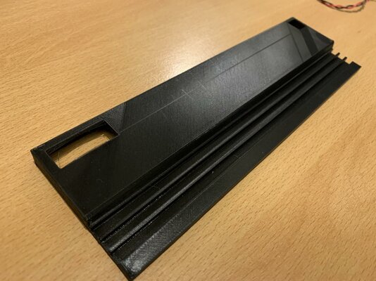

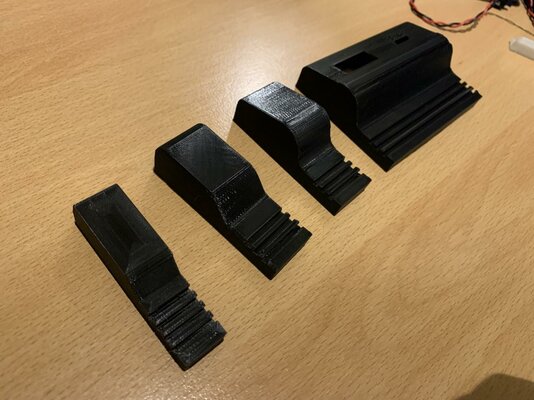

So I started up Fusion 360 and made a first version:
Okay, that was not yet what I wanted it to look like. So I experimented with the profile and finally found a better looking version:

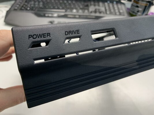

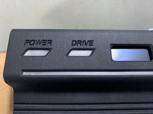

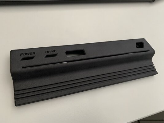

I printed a complete bezel with my 3D printer, but the quality wasn't good enough for mouting it on my case. So I ordered the bezel and the power button at a 3D printing service. I was really impress by the quality of the product.

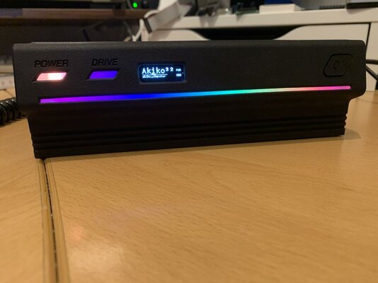

Of course a simple bezel with 2 leds and a button is pretty boring. I wanted to spice it up a bit. The result is this:
Two Leds for Power and HDD, a small Oled that can display the Akiko32 name and will also update on Power/HDD change. A power button and a small band for RGB lights.
All I had to do was now printing some transparent parts for the Leds. And write "a litte bit of" software :D
Pretty much stuff inside the bezel:
Of course, it fits nicely onto the case:
To the left is the controller (An Arduino Mega as the Leonardo has unfortunately not enough space). There will be two control buttons for the RGB band: One for the color, the other for the mode: There are 8 animated modes, all that fancy stuff like breathing, color cycling, a rainbow effect and of course the Larson scanner effect of K.I.T.T. :cool:. BTW, the RGB band has 24 WS2812 leds.

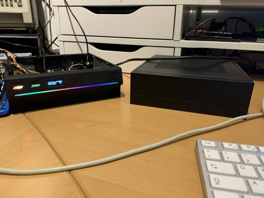

In direct comparison with the original case, I'd suggest that the new bezel is more Amiga like:

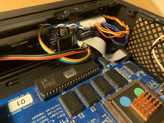

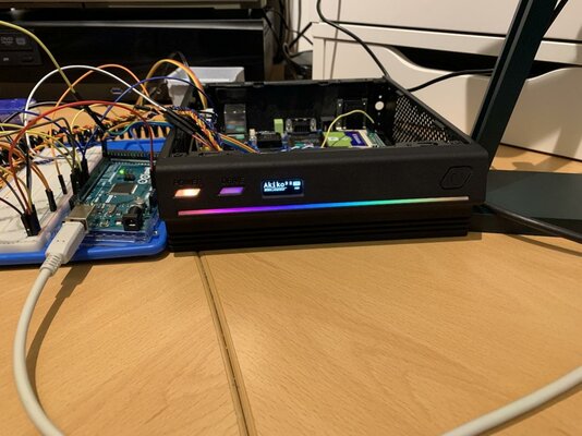

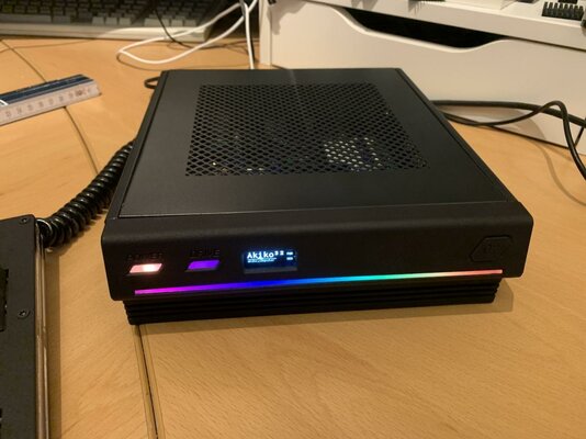

Just a small update to the bezel. As a prototype, I used an Arduino Mega sitting near the case:
I called the controller chip KARL, because Karl kontrolliert auch RGB Leisten (sorry, German joke) :D
I had some problems with the Atmel IC first, but after a real odyssey I finally found a working programmer for the board and now the board is working.
Now all necessary connections for on/off, power led, IDE led, the led bar and the Oled are summarized here. With the 2 buttons you can set the program of the led bar and the color. (Of course, there is not only the rainbow effect, but also a Knight Rider effect and others :cool:)
The board is screwed into the case and connected to the Akiko board with a ribbon cable:
And finally you can close the case again although untypical for an Amiga :)
It only needs a shield for the IDE led as the led bar shines through when the IDE led is not lit.
