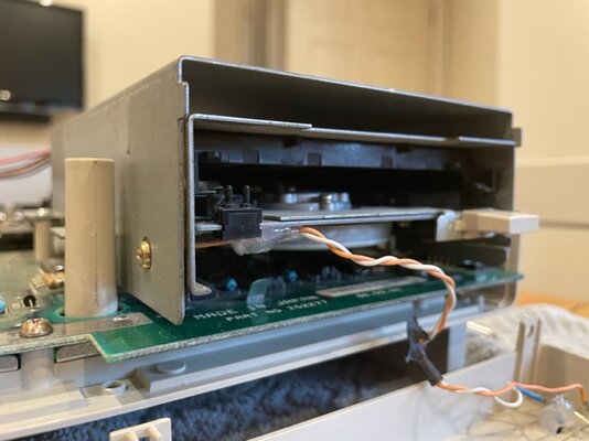

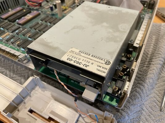

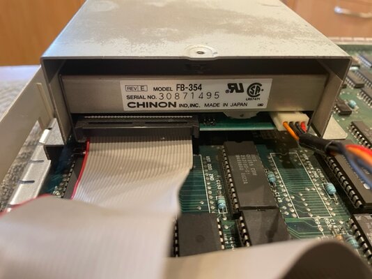

The drive fits without mods. It’s just the bar at the front where the button is, is slightly shorter, so I used a little hot glue to stop it falling off the end. I’ll take some pictures tomorrow for you.
Hope these give you some idea. As you can see from the outer case the original drive was a Panasonic (Matsushita), but the drive fitted is a Chinon FB-354. The eject button is the original removed from the Panasonic drive.
