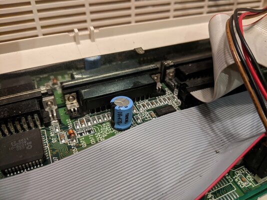

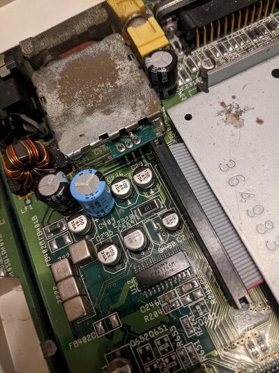

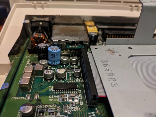

Hello,
Can someone help me identify if my Amiga 1200 needs recapping or not. Just want to check these are the original capacitors first before getting it done.
Thanks for any advice.
Cheers.

You should get that recapped ASAP. Although the caps look in reasonable condition, they could fail at the most inopportune time due to their age.
Panasonic polymer caps are recommended. They are of very high quality and should last a lifetime.
Do not accept any tantalum caps as replacements if offered as they are liable to explode.
