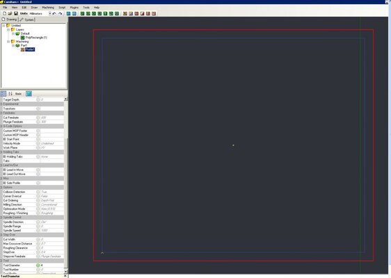

Ok, a .DXF (Autocad Exchange Format) is a vector orientated file, but you still have to specify some parameters, so look at this piccy.
The part that needs to be cut out is in red, the blue square is the toolpath, and that's smaller, why? Because I used a tool of 4 mm, when you're using a laser, then the tool size is (almost) neglectable.

OK thanks, I guess am going to have to do a bit more reading on this subject as I had (naively) assumed I could draw a square with a circle in middle and end up with a square piece of metal with a hole in it!! Lol
So on your example here would everything between the red and blue disappear/bet cut out by the drill? And is that space 4mm as per the size of your drill bit?
