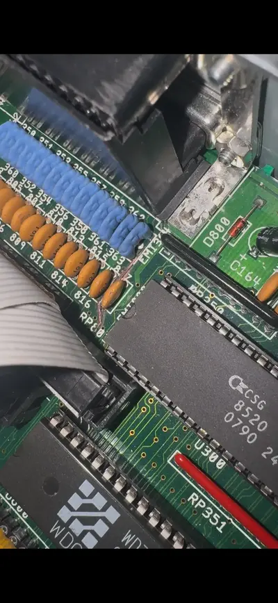

I’ve recently assembled an Amiga 3000D. I had purchased the rare custom chips individually then chanced upon a bare motherboard and case. I’ve sourced all the chips, I have the Buster 11, SDMAC 4, Ramsey 7 and 00-08 SCSI chip. I have booted the machine from floppy and software runs nicely but I’m having trouble getting the November 2025 release ZuluSCSI I added to recognise anything on the sd card. I’ve checked the red wire on the scsi cable is on pin 1 on either end. I have a hard drive file I created with WinUAE called HD0.hda on the root of the sd and when I switch the machine on I see the debug log showing that the virtual hd file was recognised and loaded by ZuluSCSI, I see a quick single led flash. I have the terminator dip switch set to “on” but with the sd card plugged in all I see is a grey screen. I’ve tried rebooted with the two mouse buttons held in but never get the boot screen, just grey. If I take the sd card out then I get the kickstart screen and everything runs normal.
So, is this a scsi termination issue? I’m wondering if I need to put the resistor terminator packs on the motherboard. I don’t have any but not sure which ones I’d need if this would resolve the issue. I think it’s RP802, but there are another two RP sockets behind the SCSI connector, 803 and 804. Are all three needed for the termination? Could I use a DB25 external terminator?
Or is there something else wrong?

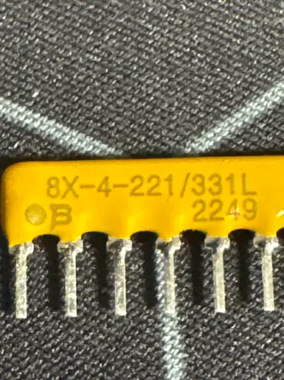

Edit: Absolute legend, thanks so much. So I guess I’ll just buy three resistor packs from Mouser for the RP802, 803 and 804 sockets. As I understand it they’re 330ohm each. Anyone know if they’re “bussed”?
Edit: Okay so this wording from Chucky on the ReAmiga 3000 instructions clears it up "if you have external units, you should not have termination on the motherboard. See the whole chain as ONE cable and the motherboard is in the middle!"

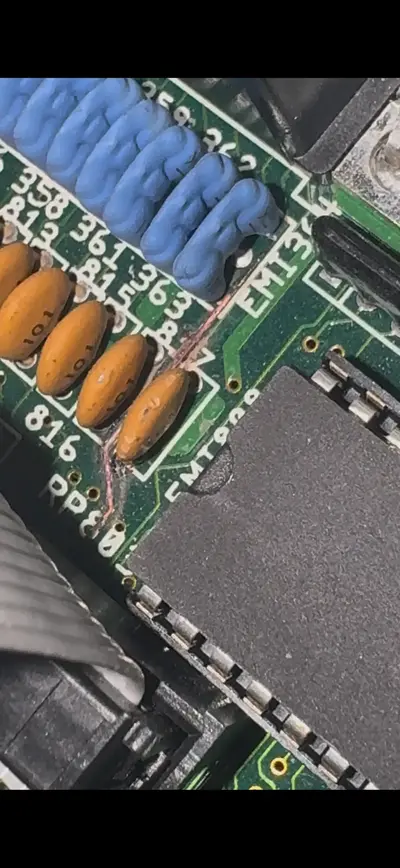

Edit: So I’ve put the 220/330 sip resistors in place but still getting no HDn.hda files recognised by the Amiga even though the ZuluSCSI log files says they’re mounting. I’ve done a diode test on D800 and I’m seeing 0.0v measuring with either polarity. Is this an anomaly because the diode is soldered in or is that suggesting a bodgy device was plugged into the external DB25 and blown it?
