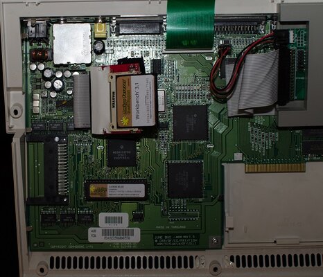

Could you aslo put some pictures on this topic?
1) The "Amiga Forever" one with Workbench 3.1. Not sure what manufacturer that is. The problem persists even when I remove the CF-card though (and use the USB-floppy).
2) Nope, no chip RAM.
3) Without the accelerator card:
