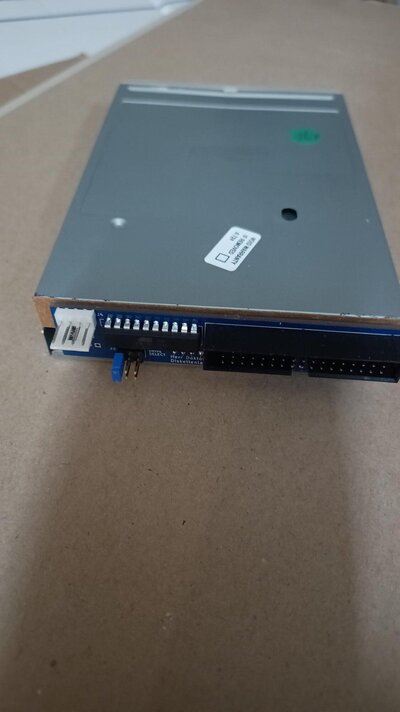

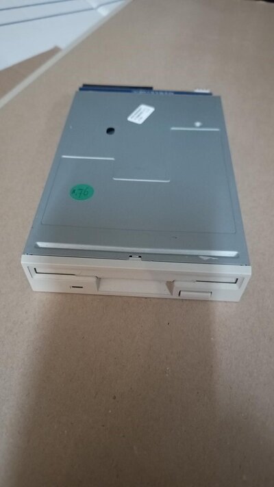

Amiga HD DiskDrive , can use for all amiga's from 500 till 4000 ( you can also jumper the drive df0: df1: df2: )
all test on 720/880 1.44/1.76 format with no error's
price per drive including shipping with track-trace 110,- euro's >>>> Summer deal 75,- including shipping <<<<

Edit:
They are 0.25mm wires used in coils and are insulated enough ☺️
Sorry i have to go now.
Board seems ok.
Edit: The r21 resistor have not been changed. Maybe that helps.
r21 is change to 56k , and the wires are isolated , drive are test on myn a3000 and 4000 , ( i test alway the drive's befour i ship it ) maybe hi have a escom a1200 board ( that board got a fix on the back side on the disk drive connector

yes , i have test is into myn 4000 and df0: and df1: bold works as hd drive , even when i put the jumper on df2: then it works as hd drive
To be more clear, have you connected both at the same time? Can you use 2 HD drives in your 4000?
Connected the drive (data and power cables) to DF1: port of A1200 with Kickstart 3.1 and Workbench 3.1, however, I could not make it work as HD drive.
If the jumper is in the position 1, it works well as DD drive, i.e., it can read, write and format DD floppies, both Amiga and MS-DOS format (through PC1: dosdriver in Amiga Workbench 3.1). However, it cannot read, write or format HD floppies. HD floppy formatted in MS-DOS as 1.44 is not read (showing both DF1: and PC1: as ????, unknown format). If I try to format the HD floppy in Amiga FFS format, it offers just the DD capacity 880 kB.
If I try to move the jumper to any of the other two positions labeled as 2 and 3, the drive doesn't work at all.
Any hints what could be the problem and how to solve it?
