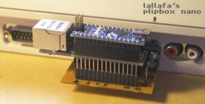

Anyone would know where to make the little PCB from Plipbox's blog, solution 1 ?
I'm in USA... and willing to try the PCB v1.1
If people are interested I can arrange a group buy of the components. I have a quote for the little PCB board from 30 USD for a quantity of 10 to 5 USD for an order of 100 (blue color, to match my GBA 1000 mobo... lol).
The rest of the components are about 30 USD, excluding a power supply (or including one if I can find a cheap on on eBay or Amazon). This is to build the compact version here :
If people are interested I can arrange a group buy of the components. I have a quote for the little PCB board from 30 USD for a quantity of 10 to 5 USD for an order of 100 (blue color, to match my GBA 1000 mobo... lol). The rest of the components are about 30 USD, excluding a power supply (or including one if I can find a cheap on on eBay or Amazon). This is to build the compact version here : View attachment 82802 View attachment 82803
Great Idea! I'm interested and very excited about this, just let me/us know in detail (also in PM) how to proceed. Thank you Rakeim ;-)
Got a very interesting quote from China for the PCB (same supplier than Tuxbar81 for his extension boards for GBA1000). Therefore I would like to design the second layer on this PCB to get rid of the 4 wires to be welded on the board. Since I'm a total newbie I need to understand how to use Eagle CAD software to do this... Might take longer than expected. I'll open a group sales thread when I'll be ready (someone might be faster than me!).
