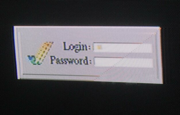

Continuing with my "Got an amiga but I'm a noob and don't understand anything" series, I bring you another question...
Purchased and A1200, and when I went to test it I found myself with a user/password prompt...
e-mailed the seller but meanwhile, googling a bit I did manage to get as far as learning how to boot without startup sequence and issue a loadwb to get workbench.
After that though, even though I manage to edit the startup sequence or user startup, I cannot seem to find just what exactly that password prompt is, or what program, etc in order to remove it...
Googling doesn't help either as I've tried countless searches to try to see what this could be and nothing, so I decided to post here, where I'm sure the more knowledgeable folks will take one look and say: yeah, that's "x"...
I did get the user and password from the seller now, but that's beside the point, as I can see already some may answer "just format the hdd",and I might do that at some point just to learn how to work with hdds and install stuff etc. , but right now I am more interested in learning what all this is and how to remove it manually.
So anyway, this is how startup goes...
- Power on the computer, start loading and get the login screen

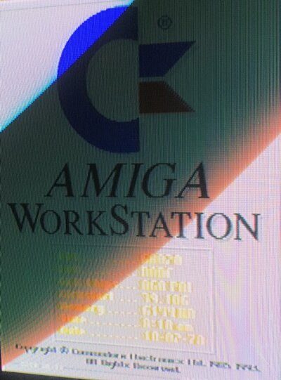

- I see a workbench title bar and then the "Amiga Workstatikn" page appears with workstation with a hardware info page
- I hit ESC and another workbench title bar and an image loads (guess the guy really liked Pamela Anderson)
- Hit ESC again and workbench loads
Attaching the screenies.
Now, anyone know what the h... this is? I know it's probably in the startup scripts but I don't know enough to identify these elements.
Edit: cannot add the "amiga workstation" info screenshot because it's too large. Will try to compress it.

Hi,
have you looked in the WBStartup folder to see if it's a app that runs on startup rather than in the startup-sequence?
That also looks like it could well be one of the many 'loading screen' image programs which usually run as apps from the WBStartup folder (I have one installed too...). :)
As RichyV points out, it could be something off the WBStartup folder. It could also be something loaded from the startup scripts at S:Startup-Sequence and S:User-Startup. My 1998 OS 3.0 setup had PicBoot (http://aminet.net/package/util/boot/PicBoot) launched from S:User-Startup to show a random image.
Thanks guys, will boot up in a few mins and check those locations and provide what the startup scripts have.
Now noob question: a picture viewer but that has a user login screen?
Ok, so in the WBSTARTUP folder, there is only one program called "MouseBlanker". Not really sure what it's fore, but definitely not it...
If I look in sys:s/startup-sequence I see this:

ALock in dh0:trashcan looks a possibility...

Pretty sure it's alock. I used it 20+ years ago. Nice looking login prompt...
If memory serves, you can lock the Amiga with some security, where it required a password and couldn't be by passed. Although, booting without a SS, nullified everything it did. Still a neat idea. And someone without a working Amiga knowledge would be stopped :).

It's a set of utilities that can also give you differing work environments depending on the login creds given. Also, it had a rudementary disk encrytion type thing too I think....

Yep, after sitting down with it a while and reading patiently, I figured out it does:
- alock. (Still need to download it to read rhe readme and figure out where the password file is,etc. Just to learn)
- openaws to display the "amiga workstation" screen with hardware info
- ppshow to display an image

yes sir, it was indeed alock.
