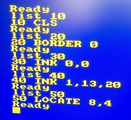

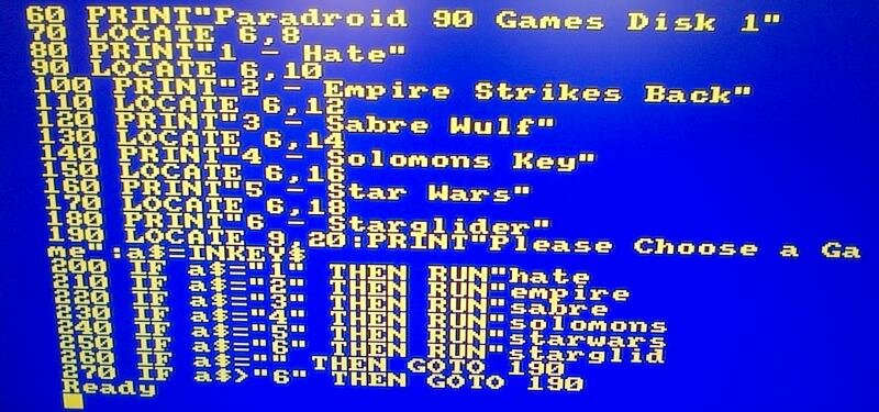

Hi Everyone
I was just going through my olde threads and realised that I never kept my promise and issued the "basic" (Pardon the Pun :-) ) menu code for the 6128 Disc Menus I have put on all my games disc.
If it is any use to anyone feel free to use :-)
