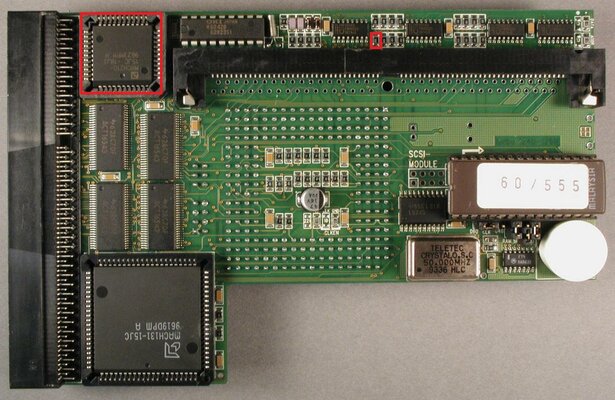

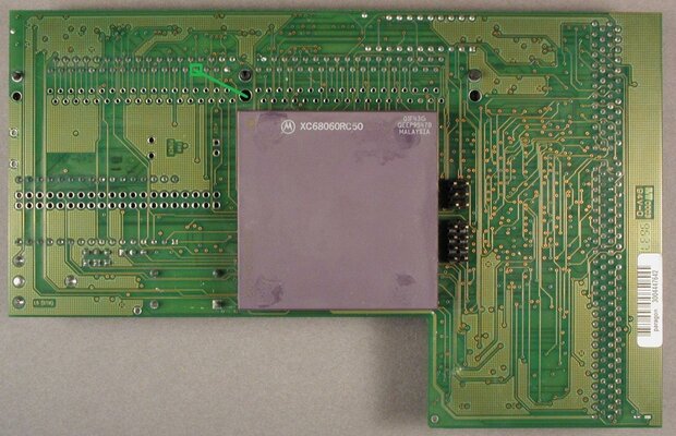

To install the module, you need to remove the memory controller socket and solder the controller directly on board. After that install module with soldering pins facing the ram socket. Then remove the small resistor market on picture.
Now solder a wire on A11 of the board. I choose to pass it on that small hole to the other side of the board. Solder the other end on the pad bellow where it says R2 or R1 or R5. Usually R2 is fine.(R3 not used, tests only)
Now solder another wire on the yellow dot shown on image, and solder the other end on R4.
Hope this helps. My A1200 with apollo is runing for almost 2 months with this mod. No problems at all.

Just switch wire on R2 with wire on R4.
Sorry about that :(
Many thx for your manual.
I followed your steps but sadly I was not able to get it working. :(
So what I did:
1.
Clock down my Apollo 1260 from 80MHz to standard 50MHz (just to be safe).
2.
Removed MACH210 from his socket. Removed the Socket and soldered the MACH210 directly onto the PCB.
3.
Did a check here: Board ist starting and I can boot to WB3.1 with my 32MB of RAM
4.
Now I put your module onto the MACH210. Soldered A11 to R4 and the other one to R2.
But the machine gives me a black screen.
So I tried some thing:
1. Removed the module from MACH210 and checked the contacts. But all contacts seem to have "brush marks" so I a quite sure they all have contact.
2. Removed the 32MB RAM module - now machine turns on. I can see the 060 CPU - but as expected - no RAM
3. Then tried out some other 64MB RAM modules: Samsung Chips, 60ns - doesnt work, only black screen
4. Then tried out some other 64MB RAM module: MT Chips, 50ns - doesnt work, only black screen
5. tried again my working 32MB Siemens module - doesnt work
6. Removed marmes module from MACH210 with my 32MB RAM module - the Apollo1260 is still working
Then I tried the different solder points R1, R2, R3, R5
But none of them seem to work with the 32MB Siemens Module nor with the modules from Samsung or MT.
So whats wrong with my RAM modules? For what kind of RAM module I will have to look for? How can I debug this?
Sorry for my late reply.
Well I changed the wires and its working now! Even with 80Mhz!
Okay okay, I didnt had muh time for testing, just booted into WB and ran starstruck :). hope I can do some stability tests at the comming weekend.
