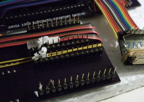

It's not a problem of video standard. It's just that the implentation of the components is different.
Here is a picture of the PAL version 1:
https://www.amibay.com/attachment.php?attachmentid=74173&d=1407790371
The PAL version 2 is the same as the NTSC one. But to connect it onto the motherboard, you'll need to solder a 28 pins socket.
If your Amiga is a NTSC version, you'll need the NTSC version of the switcher, also if you change the video standard.

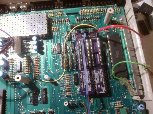

Finally managed to find some time to mount the KS switcher into one of my A1000a...:)

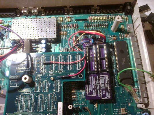

But I did some changes in the wiring part...now it is easier to remove the switcher (for whatever reason...:overactor:). The main reason of my mod is to avoid soldering to the PAL chip and to the CPU (as I have plans to change cards there)...Just needed to find some easy locations of the signals where I could solder a pin/connector....
Below are some pics of my mod....if anyone interested....
You have made a good job Croupier! I see were you have pick up the signals onto the piggyboard.
For the Reset signal, I assume that you have searched somewhere else onto the motherboard.
Since we have to modify the motherboard, it's not a big problem to solder wires.
If we want to remove the adapter, we'll need to modify again the motherboard!

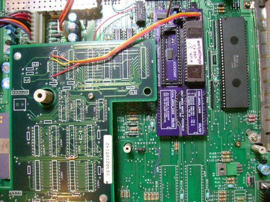

So, actually, the simpliest way is to solder the three wires onto the DAUGCAS IC like that:
Wire 1 -> PIN2 of DAUGCAS
Wire 2 -> PIN9 of DAUGCAS
Wire 3 -> PIN8 of DAUGCAS (RESET signal - Instead of PIN18 of 68000)
Here is a picture made by MarcelV:
