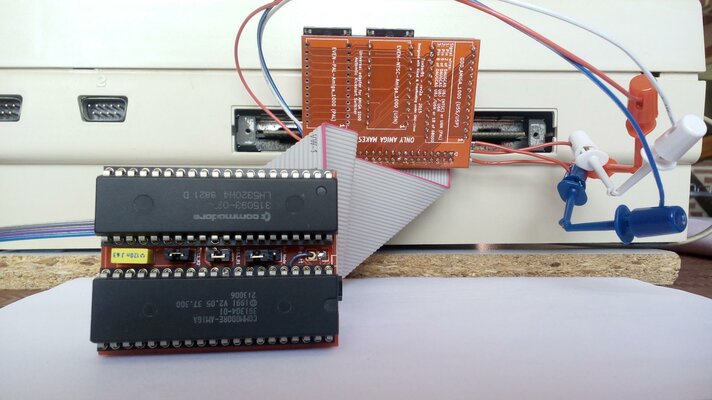

For information, five PAL switchers and 3 NTSC switcher are assembled (pictures below). Tests will be made tomorrow. :-)
Tests made. Finally, 10 operational switchers. 8 PAL + 2 NTSC.
1 NTSC doesn't work since I've oriented one IC to the wrong direction... :double:Doh::banghead:
Will be corrected and tested tomorrow.

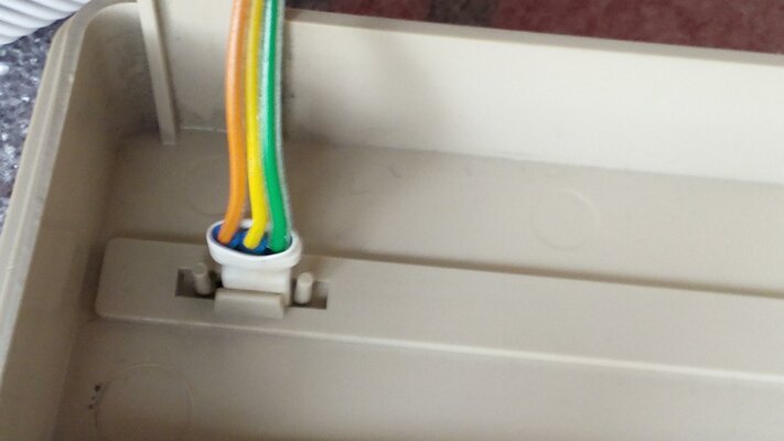

As you know, there is a bi-color LED which allows you to know when the KS is switched. This is a rectangular LED which is unfortunately smaller that the original one of the A1000.
I have found a solution to allow you to replace the power LED of the A1000 with the bi-color LED. Now, the bi-color LED will be coated with heat shrink tubing. Like that, the LED stays in place into the hole of the power LED!
Pictures below:

That was true with the very first version of the switcher. Since the switcher is a ribbon design, there is only one installation method. Now, you have just to plug the Universal PCB onto the two sockets of the A1000 PAL (modifications onto the PCB: resistor to add, track to cut are always needed).
The manual needs to be rewritten. The installation procedure is the same as the one used for the first version of the switcher which didn't need the soldering of a new socket onto the motherboard of the Amiga.
