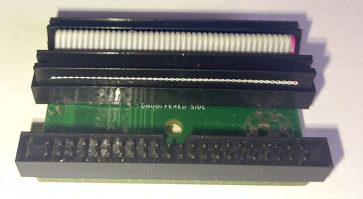

@mattsoft
Have you asked your TF536 builder if their newly available buffered interface works with it?

Thanks all - this is great information. I do see empty footprints for a few ICs next to the IDE header so this board most likely does not have the buffered interface. I will investigate the adapter @miggymad mentioned above and stick with the shorter cable for now.

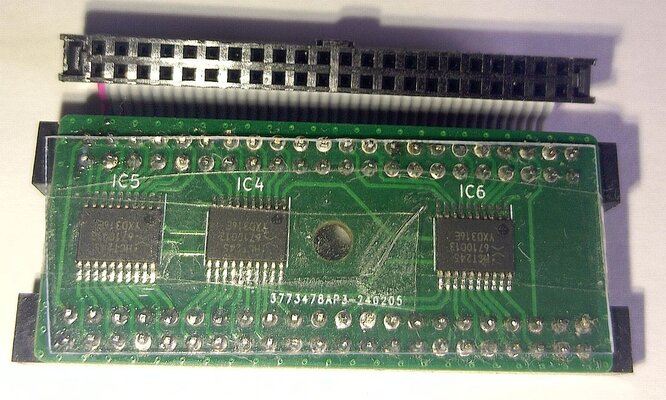

@mattsoft
Just for some further insight and real world experience, I recently hooked up a buffered interface to one of my TF1260's along with various length IDE cables plus an SD card adaptor and ran some tests. The results are as follows:
SD card adaptor (5cm cable) - works (y)
SD card adaptor (30cm IDE cable) - fail (black screen & lockup) (n)
SD card adaptor & buffered interface (30cm IDE cable) - works (y)
SD card adaptor & buffered interface (50cm IDE cable) - works (y)
I also plugged the buffered interface directly onto my A1200's IDE with nothing on the TF1260's IDE and achieved similar results. Without the buffered interface fitted, no IDE cable over 5cm worked properly. A black screen or guru's were the usual end result of the tests.
