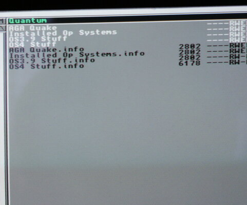

@ ravestar

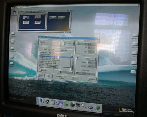

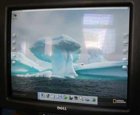

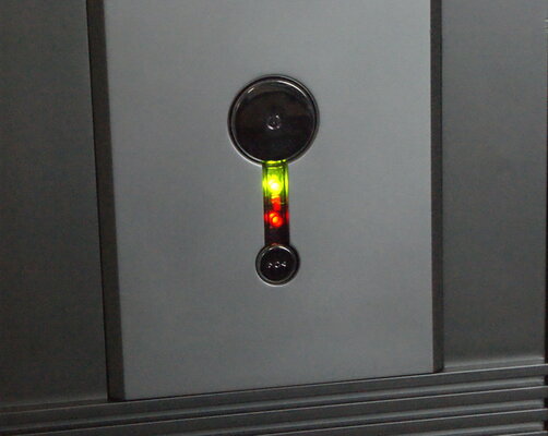

Couple more Pics for reference. Having fitted a small IDE hard drive as well as a 73GB SCSI drive, I literally shoe horned a small rectangular LED into the original LED mounting. The IDE drive uses the stock red LED & the SCSI uses the rectangular LED. :thumbsup:
The screen shot of the Quantum drive under Dopus is the backup drive. The backup drive will always show if ever things became so dire, you had to boot from a WB floppy. On the Quantum drive, you have all the required files for a full re-install to how it is configured now & there is a full back up of the Installed OS as it ships. Worst case scenario to restore the OS is boot with a floppy & copy the Quantum backup of OS3.9 back to the System partition.
ReOrg works on the first 3 partitions as they are inside the 4GB boundary. One of the reasons I put all your more important partitions here. :wink:
I would recommend you use a more professional file system for a little more speed & reliability & leave that pleasure to yourself. I've used PFS3 in the past & it's a complete sod to configure. There are others but again, it's all down to user preference.
I'm still wrestling with the box for shipping. I have had to make one from 2 x 26" Panasonic LCD TV boxes & I'll upload the pics hopefully in the next few days. Finall specification of this Elbox Tower is as follows:

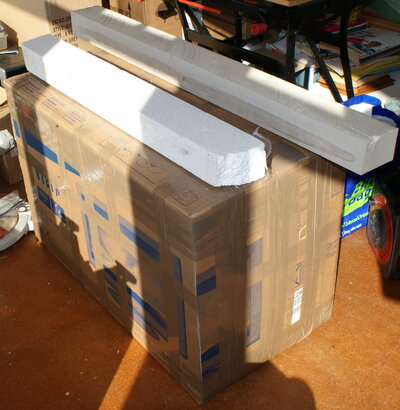

Packing the Tower for it's journey to Italy was suppose to be a well photographed event. Indeed, I took several pictures of the various stages from the original 2 x 28" LCD TV Boxes right through to the contents being installed in the packing case. Alas, total "Face Palm", no frickin' Memory card in meh Camera! :Doh: :laugh: :|
Anyway, the box measures 92cm long x 46cm wide x 58cm high & as you can see from the pic, those Foam blocks measure 10cm x 8cm. There are four of them in the bottom of the box 'long ways on' & have a profile cut in them approx 3cm deep so the A1200T Box & an A600 box fits into this recess. There is also a keyboard end-shape cut out as the Keyboard is stood on its end all wrapped in bubble wrap. Then before the box was sealed, 3 similary notched Foam Beams sit on top. The ends & corners are packed with huge slabs of Polystyrene foam.
Enrico was asking for an A2000 or 600 a little while ago, so I've also let him have my A600 & shipping it with the Tower was just the most logical thing to do. We have a gentlemans agreement that should square up in early November.
Really sorry about the lack of detail by way of pics, `cos it's one hell of a packing job & wasn't really that hard to do. The foam beams can easily be obtained from any builders merchant. They usually make up the main supports for sheets of insulation material & get thrown away. There are just over 3 rolls of Brown Tape used in this constuction & providing the package isn't dropped or crushed, there should not be any problems.

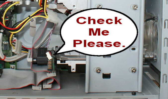

When you get the A1200T from it's box, I suggest you take off the Left Hand Side Panel & make sure everything is plugged in securely. I can only see the SCSI Hard Drive Converter suffering, so make sure it's pushed into the hard drive as far as it will go.

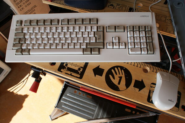

The mouse plugs in the the very Top rear 9 Pin Port. ;)
When you pull the Keyboard Bubble wrap pack from the crate, remove the Pink end first (should be uppermost when you open the crate) to remove the mouse. Pull the other end off & then cut tapes to unroll the software & eventually, the keyboard.
You will also see several Plastic Sleeves containing all the relevant paperwork for your A1200T, including full instructions for an install. In the Indivision Box, there is also the original KB convertor as supplied by Elbox with the tower.
