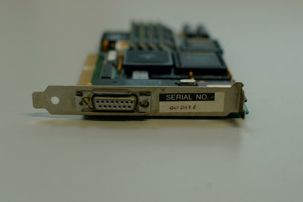

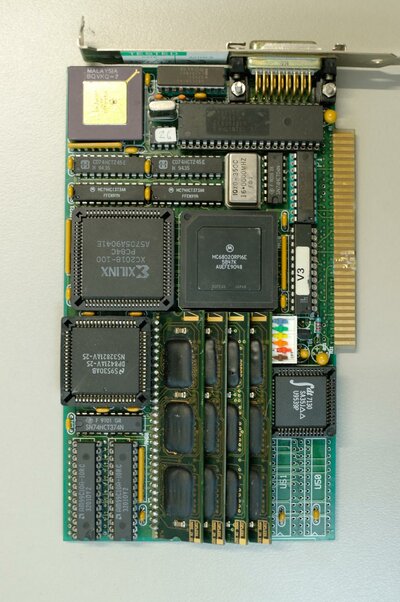

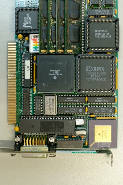

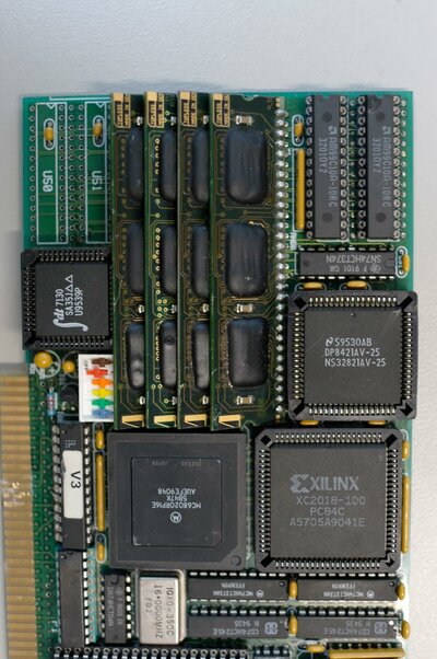

Hi All,
I saw this board for sale the other day and had to have it (The components looked so similar to an older Amiga accelerator that I was intrigued). The owner didn't know anything about it (Except that it's copped a knock at some stage on the traces).
Whatever it is, it's been now been saved from becoming someones wedding ring anyway.
From what I can tell:
A) ISA?
B) Pretty epic for it's time!
C) Motorola MC68020RP16E CPU & MC68440R10 MMU
D) 4x “Topless Germany” (Soldered) Ram sticks.
E) 15Pin DSUB
F) The long IC (which you can’t read in photo) is Intel P82592 / SZ158 / L0381327 (’87) (Might be programmable IC)
It could be one of a million custom boards for industrial use and perhaps impossible to identify. I’m more interested in what the card does, rather than it’s exact designation. Whatever it is, it would have cost a fortune in the 80's.
It has a 15 pin DSUB which I thought might have something to do with an Apple display? But after hours of Googling, I kind of got the picture that the older 8-bit ISA (IF that is what it is) could mean it was meant as some kind of CPU accelerator board for AT/XT Machines? Surely 16Mhz is too way fast for both of those machines? Is it a bridge board perhaps?
It says "LAN LABORATORY - LA-ETHERv1.0/I3 on the reverse side, but Google slammed the door in my face when I asked what that was.
I’m attempting to attach readable high-res images, not sure if they will still be clear after the upload process optimises the photos.
Has anyone seen anything like this before? Very interested in any theories. Thanks.
15pin DSUB may also be AUI network interface. (also if i recall correctly, XILINX chips are on some of my older network/modem cards as well)
Thanks SaviorX! That certainly fits in with the "LAN" & "Ether" nomenclature on the PCB.
it certainly is a 'robust' card in any case....especially given it was most likely intended for an XT type system.
if i were absolutely forced to guess, i'd say an accelerated/buffered AUI network card, possibly intended for a server XT system.
the only conceivable reason i can think of for a math processor to be on it however (in that case) would be for the real-time generation/handling of 'CRC' type data (and possibly on-the-fly compression of data), being that this card would actually be faster than the PC it would be in. (16mhz vs possibly 4.77-8mhz, which would also be in line with the ISA slot speed (16/2=8 )
the Intel chip presumably handles irq/communication with the host.
but...this is just a guess.
for all i know it could've been intended to operate heavy machinery via the network interface...
whatever the case, i am seeing absolutely no reference to anything on the net in regards to this card, drivers, or any software related to this card seems to be non-existant....so unless someone has an identical card somewhere... :P
oh yeah..and the on-board RAM is 30-pin, indicating they are likely standard 30-pin SIPPS, and given its an 8-bit card I would assume 256k x4 / 1MB

the xilinx is a CPLD/FPGA type of device, not a dedicated network chip..
DP8421 is a DRAM controller, so likely for the four sims...
Intel P82592 is a network controller chip, so likely this could be a PIC containing an AUI interface, but the memory and processing power suggests that it is more than just a plain network card..
