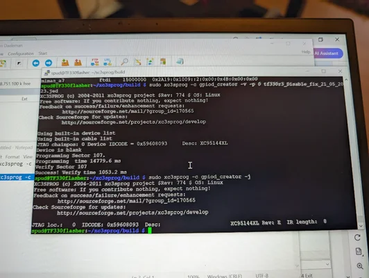

OK, I managed to flash the card. I think it was successful, see picture.
However, with the switch connected as in the other picture, I just get a black screen in one position and a working TF330 in the other position. Positions of the switch all the way to the left and all the way to the right. I assume having the switch in the middle is not what is needed, hence there's no use to connect the third contact.
Thanks for helping me out!

Unfortunately, even after reflowing the pinheader solderjoints, it still doesn't work. The jumper definately shorts the two pins.
Enable works fine. Disable still gives black screen. Is that the same behaviour a TF330 gives without the proper firmware? So would something have gone wrong with flashing? Although it seems to work fine in enable mode (not thoroughly tested yet). I was a bit puzzled with the device is blank message here.
I think it always says that "Device is blank", I remember the same from flashing TF1260, but it worked anyways.
So don't be alarmed.
