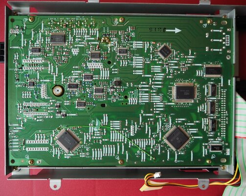

I am about to undertake a recap on my CDTV, starting with the CDROM as it has difficulty starting and the PSU, just in case. Does anyone have a Capacitor list for the CDTV, the mainboard, CDROM and/or the PSU?
If not I will update this post once I open her up, and add what I find.
NOTE: Thank you for all the replies, I think this will become valuable thread for any CDTV owners.
UPDATE: Just finished a tear-down of the CDTV, and it was a real pain to get to the CDROM PCB, got there eventually. Looks like my CDROM PCB has had quite a bit of rework, an IC was added on a separate board and an additional capacitor was added. See attached images. The capacitors are all low profile/short except two near the power connector, but I have included the sizes in the table.
UPDATE2: CDROM and Front Panel Recap done, all initial problems fixed, non spinning CDROM and weak IR. Note there is a hidden capacitor inside the shielding for the IR on the front panel. Its a pain to get into as you have to bend the metal shield open to replace the capacitor. I have also fixed the PSU capacitor list as it was missing one cap value and two caps were mislabeled.
CDROM PCB

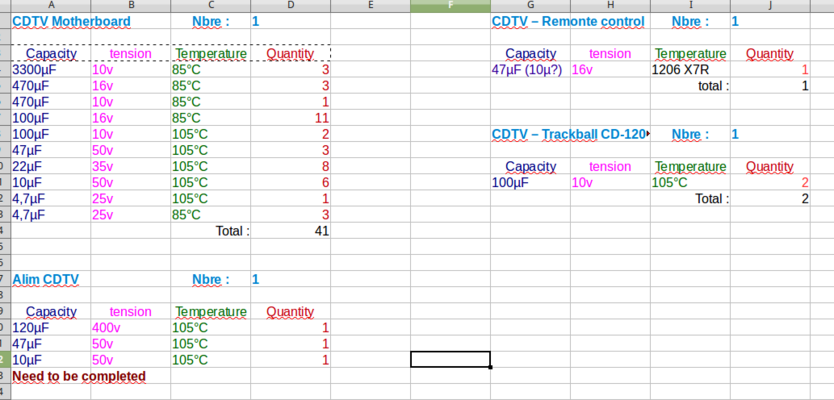

Note: All Capacitors rated at 85°C

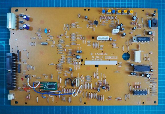

Main PCB - Motherboard version 2.2.1
[TABLE="class: grid, width: 500, align: left"]
[TR]
[TD]Amount[/TD]
[TD]Spec[/TD]
[TD]diameter x height (mm)[/TD]
[TD]Numbers[/TD]
[/TR]
[TR]
[TD]4[/TD]
[TD]4.7uF 25v[/TD]
[TD]5X11[/TD]
[TD]C171, C172, C174, C76[/TD]
[/TR]
[TR]
[TD]5[/TD]
[TD]10uF 50v[/TD]
[TD]
5X11
[/TD]
[TD]C163, C162, C155, C85, C14[/TD]
[/TR]
[TR]
[TD]9[/TD]
[TD]
22uF 35v
[/TD]
[TD]5X11[/TD]
[TD]
C177, C178, C29, C59, C60, C79, C80, C20, C11
[/TD]
[/TR]
[TR]
[TD]2[/TD]
[TD]
47uF 16v
[/TD]
[TD]5X11[/TD]
[TD]C164, C82[/TD]
[/TR]
[TR]
[TD]2[/TD]
[TD]
47uF 50v
[/TD]
[TD]6x11[/TD]
[TD]C152, C23[/TD]
[/TR]
[TR]
[TD]12[/TD]
[TD]
100uF 16v
[/TD]
[TD]6x11[/TD]
[TD]
C125, C72, C175, C165, C173, C81, C84, C43, C42, C41, C40, C6
[/TD]
[/TR]
[TR]
[TD]1[/TD]
[TD]
470uF 10v
[/TD]
[TD]8x11[/TD]
[TD]C76[/TD]
[/TR]
[TR]
[TD]3[/TD]
[TD]470uF 16v[/TD]
[TD]10x12[/TD]
[TD]C71, C77, C54[/TD]
[/TR]
[TR]
[TD]3[/TD]
[TD]3300uF 10v[/TD]
[TD]18x16 (Short and Fat)[/TD]
[TD]C2, C61, C69[/TD]
[/TR]
[/TABLE]
PSU - all rated 105[FONT=DDG_ProximaNova]°[/FONT]C except C9 at 85[FONT=DDG_ProximaNova]°[/FONT]C
