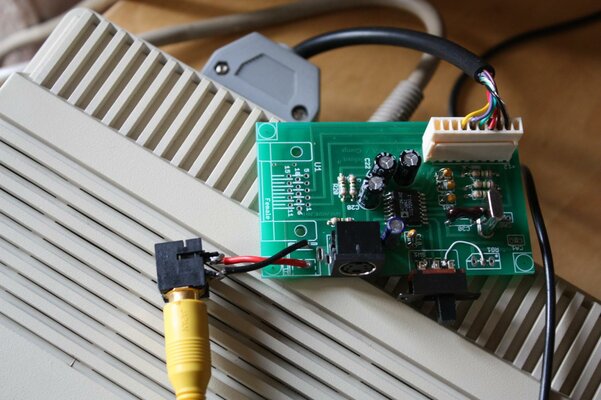

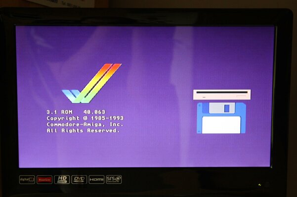

This afternoon I finished debugging and testing some prototype boards that provide composite video and s-video output from the Amigas RGB connector.
They can operate in PAL 4.43MHz or NTSC 3.58MHz via a switch.
Will post up some piccys tomorrow but the S-Video output is superb ;)
Have to think about options and configuration as well as platform compatibility before I start laying out a final PCB for manufacture.
To help does anyone have a spare Atari ST 13pin video connector to donate so I can design in this option, in the meantime I will start trials to add TTL RGB capability using my trusty BBC Micro.
Dont get too excited folks still a bit of work and testing to go before commiting the design and ordering parts.

As Promised ---- Pix
The Final Board size will be half of the prototypes and have capability for TTL RGB as well as separate sync inputs, and of course The ST, ie dual supply +12V or +5V
:wooha: thats cracking quality! Is it going to be external? If so, is there a way to make it internal?
Bas and I were discussing the headers on the board and as the final versions will be smaller than the prototypes, you should be able to connect internally to most systems.
The intention is to make this cross-platform, so you can fit this to BBCs, Spectrums, C64s, etc.
We are also looking into parts supplies, to ensure that we can produce these in volume.
Patience; more testing is needed, before the design is finalised.
Good things come to those who wait.....;)
