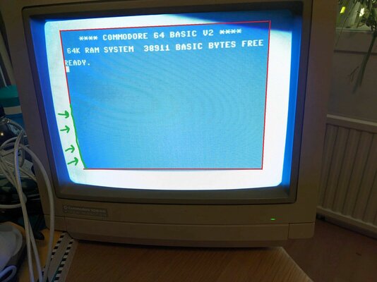

I'm not sure what to call this phenomena but I recapped this Commodore 1084S-D1 a year ago and it has worked fine up until now, when the bottom left quarter of the picture has started to "fold/bend" towards the middle.
I dunno how well it shows in this photo but I've been trying to illustrate using the borders of the dark blue square. The red lines are straight but on the left side the border is only straight until about the middle of the picture and then it starts to bend towards the middle. (illustrated in green)
I've tried degaussing with a degaussing coil to no avail. Also tried moving the monitor around to make sure there's no interference at its original place. Also tried with different computers but the problem persists.

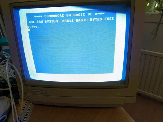

When moving the picture all the way to the right it can more clearly be seen by the white "edge-border" that it starts to bend towards the right of the screen about in the middle. (see pic)
I'm not sure what to do next but any suggestions are deeply appreciated.

i cant really see the issue your talking about clearly,plus deguassing wont have an effect its not a purity problem if an edge is bending

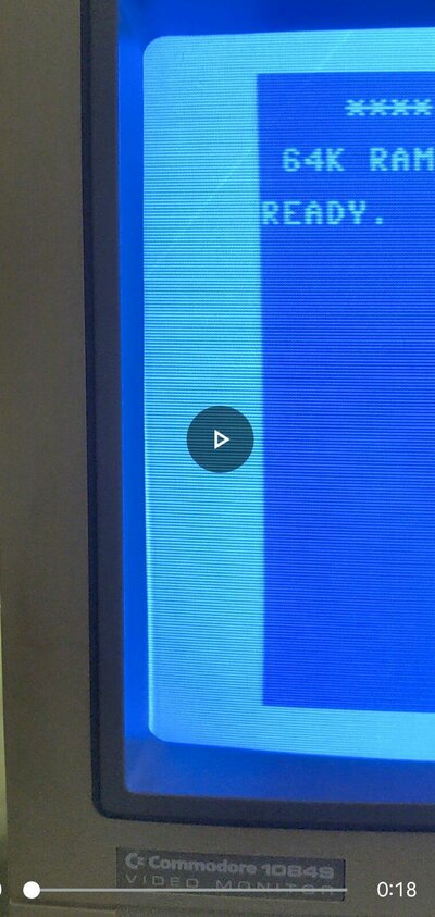

and your video dont play,so im not sure how i could help
Hey @roy_bates I'm happy to provide you with further info but not sure what info I can provide to explain the situation better.
The "video" is just a screen shot since I wasn't able to get a good photo directly. But what you see on the screenshot is basically the white border-line. If the picture was straight you would've been able to see the white line all the way from bottom to top, but now since the image is bending in the middle you can only see the white border on the lower half of the picture where it starts to bend towards the right.
is it sortof tweeking back and forth from left to right,like a twitch?
if you can do a video at least 30 seconds long and link it here,make sure the ebntire screen is in shot and try to niot move the camera around,do you understand

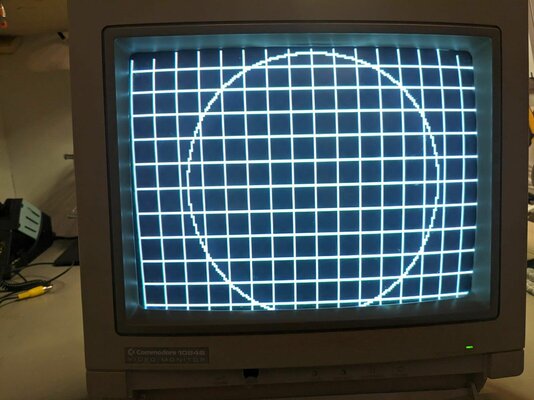

actually,can you put a grid on the screen,are you able to do that? instead of a c64 boot screen,its so i can see how far in it goes when it twitches,does that make sense?
thank you,if you have the schematics,have a good look and check components in the pincushion circuit and or horizontal position
