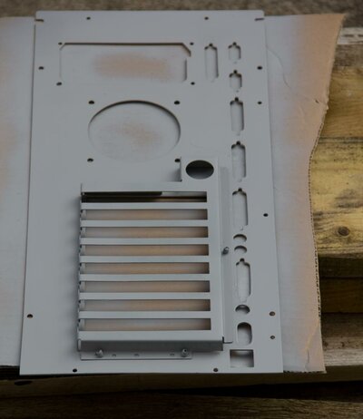

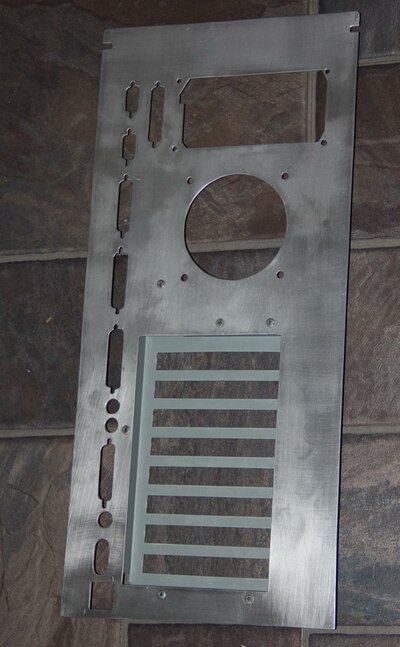

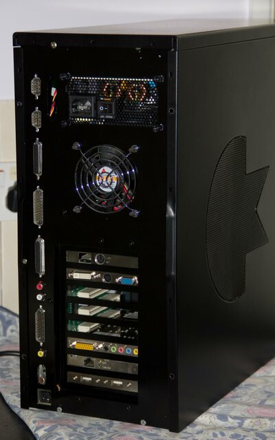

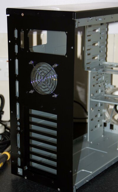

Hey all, just wanted to mention that with an A1200 main board and mediator fitted inside this case, the side mounted fan is too large to allow re-fitting of the side panel. It hits the PCI cards (unless low profile PCI cards are used).
I've attached a few of the many images of the mod I'm doing.

I started off drawing a CAD model in Rhino 3D, but it was easier just getting a blank piece of material and fabricating the panel, a bit like Orange County choppers I suppose. I bought a blank piece of aluminium 500mm x 250mm and marked out the A1200 ports and PSU and fan holes. These were then chain-drilled and filed. It's not as accurate as I would have liked but I'm happy with it. The PCI slots were actually from an old PC case that I had, 8 slots in all. I still need to make a piece to hold the PCI cards at the opposite end to where they are screwed in.
