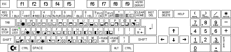

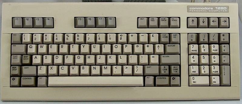

Hi!
I'm really 128'er... but also interest into Amiga...
My current project is advanced keyboard for C128D... look at image...
I want to use Amiga keyboard to C= Key interface by remapping keyboard layout... really is for me missing C= key... better to say two, to be safe three... C= key has not same width like Amiga key... so there is really big visible effect... maybe it looks like detail, but visible...
Look at my project image, and layout remapping image of Amiga keyboard...
For project C128D keyboard I used keys from Mitsumi keyboard, and for Amiga 128D keyboard I bought A4000 keyboard and using A1200 and C128 keys...
Missing is only C= key...
Miro
