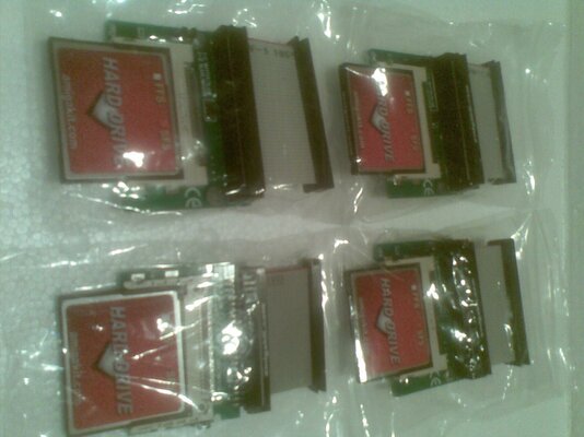

Phew thanks Tony, these 4 gems just arrived in the mail from AK today and I was thinking hmmm... to finally enter the realm of alternative HD solutions and look at all the bad press ;-)

Did you use the same kind of compact flash adapter on all of them? Maybe that's the flaw in your setup? I'm not trying to discredit your use of CF, but instead trying to find out why all of your cards fail.
