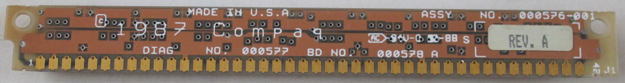

Looking for some simms for my 386 compaq portable III. I believe they are 40 pin simms, not standard 30 pin.
thanks!

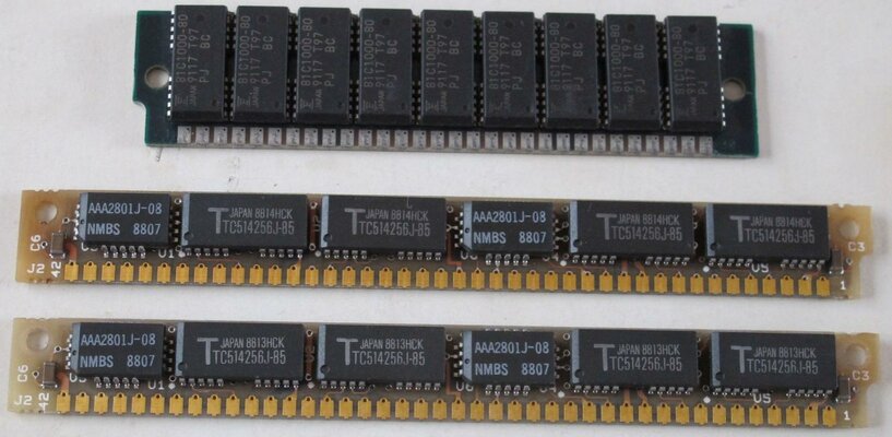

Are these the ones you are looking for ? (they came from a compaq portable but cant remember which)
The 30-pin is as a reference.

also found a picture of the inside of a Portable 386 ('upgraded' to a 486) which took those '42 pin simms' here: (they appear to be what he needs)
http://www.386page.com/systems/Compaq/portable-386/portable386.php

sundown79,
those are indeed the correct ones that i am looking for!
i pm'd your message.
thanks again!
mike
