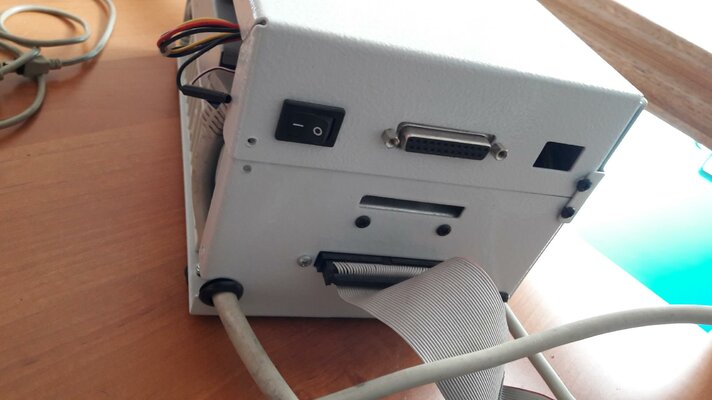

I would like to share about my new baby. I rid of Oven case(black/red) and I designed new one - PicoTower for Amiga1200. Dimensions are 250x140x155[mm].
PicoTower is designed to fit:
-1 x HDD IDE with trackable case,
-1 x DVD-RW IDE, no more problems to find right slim drive,
-1 x DF1: or Gotek and interface for it,
-1x IDE-CF/SD interface.

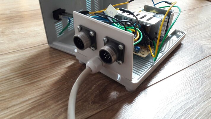

There is no room inside for PSU. I made custom PSU to power up Amiga1200/60 64MB mod and PicoTower.
Good thing about that PSU is that it turns on with one switch Amiga and PicoTower. And ofcourse has enough power to handle power consumption of set. Cables can be hook up to PSU freely - it's dump resistant

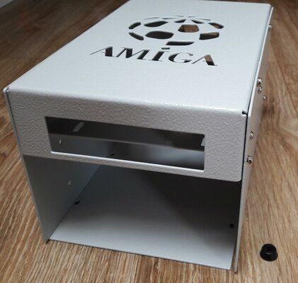

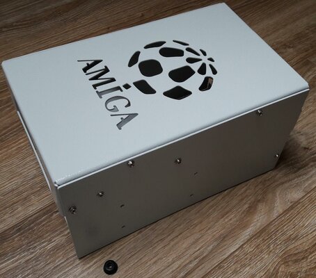

PicoTower is made of aluminum sheet. It's powder coated RAL7035 with structure. Here is just the case:

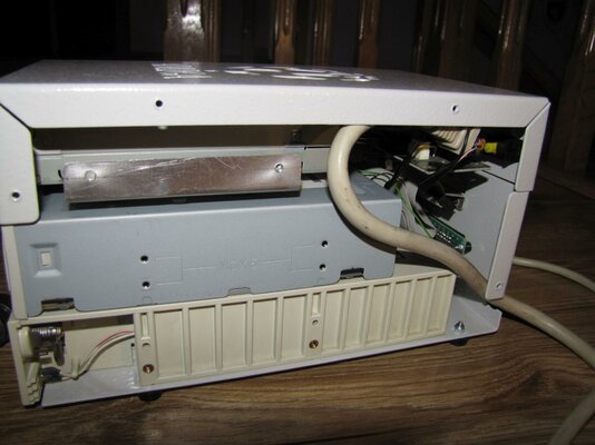

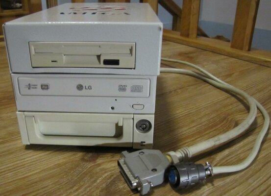

Here some pictures of "fill up" case and working one:
Leds under cuts out of case blinks as hard drive works.
