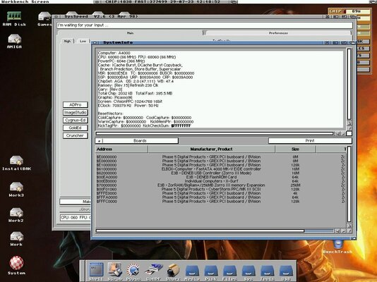

Hi to all.

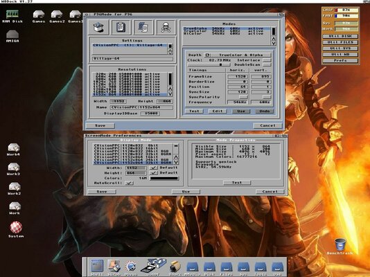

I'm just updated one of my A4000D-T's (towerized A4000D's) with the Kickstart 3.2.2.1 and Amiga OS 3.2.2.1, everything is working fine, but I can't get to work the PPC side.
I tried Warp-UP 5, PPCLibEmu, PPCUser, ... no way. The CSPPC works only like a CSMK-III.
Also, I can't use the CGX drivers, works fine only with the latest versions of P96, actually using v3.3.3
Any idea about the PPC?

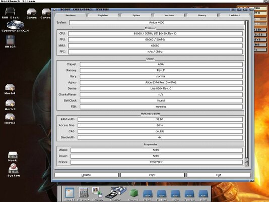

Does WhichAmiga show the PPC? Seems strange it is not giving you a reading on it I'm going off what my BlizzardPPC does
I have problems only with KS & OS 3.2.2.1, if I change the KS with the old one (3.1) and OS with my 3.9BBx setup, everything works fine, both 68k & PPC sides.
Whichamiga crashes with KS-OS 3.2.2.1
Do you use AmigaOS 3.9 and upgraded to AmigaOS 3.2.2.1?
AmigaOS 3.2.2 causes lot of trouble, while 3.2.1 works correctly.
Install 3.2.1 again and everything will work again.

I use a clean OS 3.2.2.1 setup, everything works like a charm: CSPPC (68k Mode), CVPPC, FastATA MK-V, Indivision AGA 4000 MK-I, Toccata, ZoRAM 128MB, Deneb USB, etc., the problem is only on the PPC side. The available libraries don't work and crashes the Amiga.
Warp3D also works fine, slowly of course, becasue the Permedia2, but works.
Standard, try installing:
WarpUP_V40
WarpUP_V40Upd
WarpUP_V51Upd
Warp3D_4.2a
Maybe some installation isn't necessary, but this is how it works for me.
Hi,

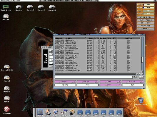

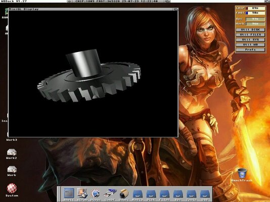

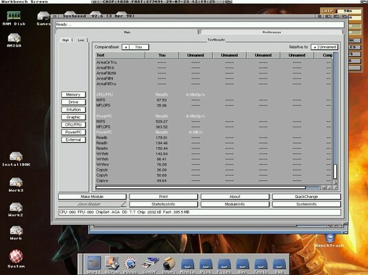

I have reinstalled the libraries and the PPC side seems to work fine. But WhichAmiga or Scout don't detect the PPC. However, SysSpeed does and the Warp3d PPC demos work very smooth and clear.
I need to investigate a bit more ...
