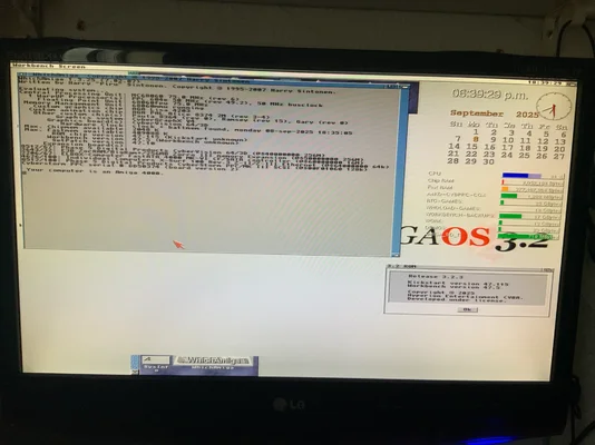

Interesting. On my Cyberstorm PPC 060@75 and PPC at 400Mhz it shows 60mhz on a A4000D. To me this is the Crystal on the board which is set at 60mhz. Showed a 66mhz crystal before Hesse downgraded it for me.
Sorry I will get a screen shot for the real amiga give me a moment
This is what my A4KD using 47.115 ROMs and 3.2.3 looks like:

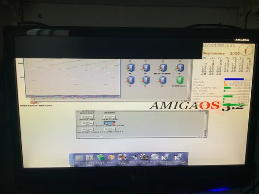

So I tried ADOOMWOS on WinUAE, it was really slow but there was no crash so I may also have a problem with the BPPC but as I said the Warp3D issue replicates in WinUAE even down to crashing the emulator when Warp3d PPC demos are activated. My Wrap3D drivers are the mediator A1200 ones and I have No MMU setup in the ENVarc Mediator folder
Mine is usually just grey window and then crash I have had it very rarely work with the small PPC demo but it too will eventually crash.
Medium and full screen PPC demos are usually grey screen & crash instantly.
I've also found that the Medium 68K demo only shows grey screen but does not crash and closes when I press ESC, but the same 68K demo in WinUAE it works.
Mine is usually just grey window and then crash I have had it very rarely work with the small PPC demo but it too will eventually crash medium and full screen PPC demos are usually grey screen & crash instantly

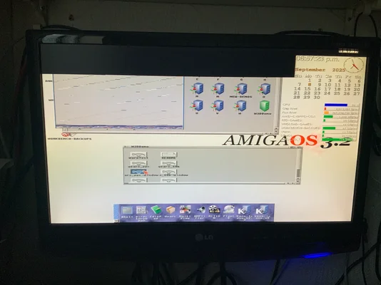

Mine might be down to the following:
- Cybervision 64/3D
- Using standard CXG V3 CYBVision 64/3D driver
I think I’m using WarpUP V4
So will try a few things, but will be backing up first 😉👍🏻
Mine is usually just grey window and then crash I have had it very rarely work with the small PPC demo but it too will eventually crash medium and full screen PPC demos are usually grey screen & crash instantly I've also found that the medium 68K demo only shows grey screen but does not crash but in Winuae it works
68k window demo does the same on mine.
So might be something I’m missing in my setup.
OK see how you get on, obviously your warp3D drivers are different to mine, Ive never looked into the ones for the C64/3D I think they are the same has the Bvision/CybervisionPPC ones
