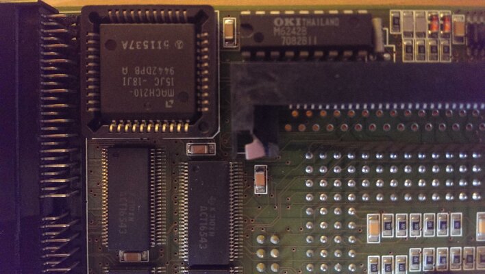

I have a dead Apollo 1260/50 - 32mb Ram (was running at 66) trade/swap against 030/50 or 040
mask 01G65V
The card was in storage for over 10yrs and the battery has eaten too much of the tracks to do an effective repair.(Sent to TheCorfiot)
He has removed the Battery
Cleaned up the PCB
Replaced the Mach socket
generally checked all points.
checked ROM
checked Voltage Regulator
downgraded to 040 to rule out CPU
Because these cards are multi layered and no schematics the card has been given up on (He tried everything)
I cannot be 100% but I believe the chips are ok,
XC68060RC50A was stable at 66mhz
ROM has been checked ok
Voltage Regulator checked ok
MACH131 not tested
32mb simm checked ok
Pictures at end of thread.

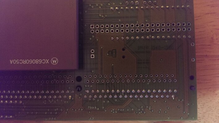

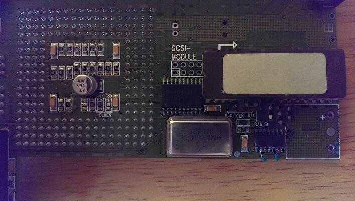

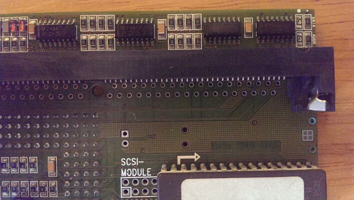

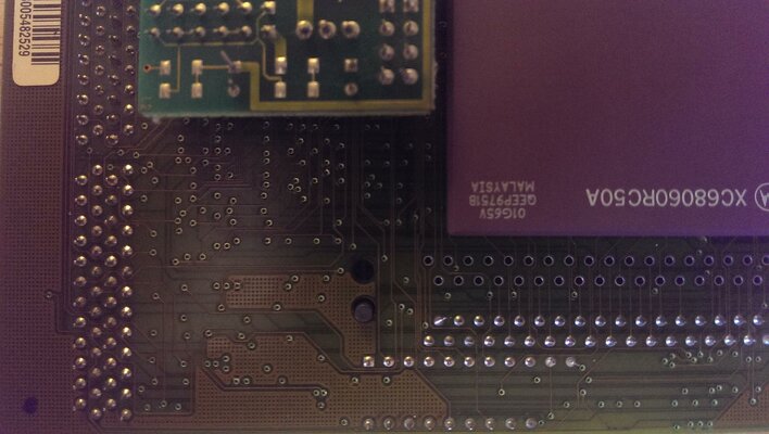

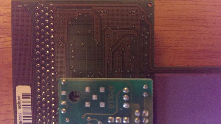

got the dead 1260 back. here are some close up photo's (i removed the 32mb simm )
