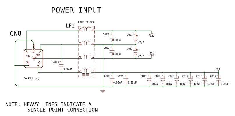

Can anyone assist with which lines to test and what I'm looking for? Where do I put my probes when testing for the most accurate results?
Here you go:
As for where to put the probes. I don't have a 500 apart at the moment, but follow these lines and test where it's convenient. Check here for your schematics:
amiga.serveftp.net/Schematics/A500+_schematics/A500+_schematics.pdf

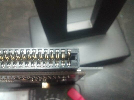

Fixed!
I checked the voltage and everything was in the acceptable +-5% range.
I started examining the ACA500 a little closer and upon inspection, it appears as though I must have been a little too rough once when either inserting or removing the card from the system which resulted in a bent connector:
After re-adjusting/bending this back into place, we are 100% operational again. It wasn't easy bending it back, but with a little ingenuity (and a sewing needle), I managed to get it!
Lesson learned- be gentle when inserting or removing cards.
Thanks for all the helpful tips and at least I know my voltage is good as well now.
We can mark this one as 'Solved'.

Normally putting a testing device at the beginning of any power lane is not really a trustworthy method of testing any electrical activity behavior on complex electronic circuitry. Anyone who wants to check the overall voltage or current drain at load should do it the end of the alimented circuitry.
I suppose. But it's an easy place to check, and you can quickly see if the voltage is less than spec.
