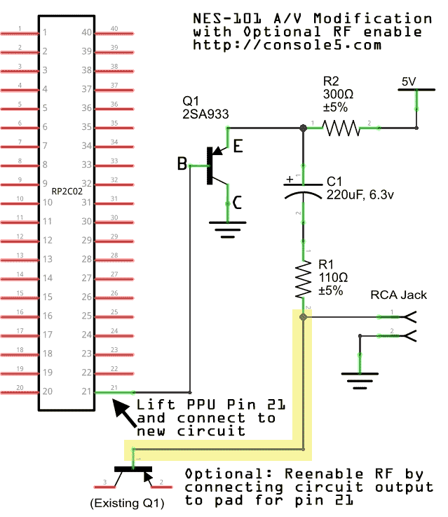

C: No AV mod here. I know that is what is supposed to be done to use it in a PAL region and right now i'm just using RF which results in a clear picture with sound (DK through a VCR) but BLACK & WHITE. Is there any possible way to get full color etc through RF without doing the AV mod ?

Problem with RF output is that it's a NTSC one. The video and audio signals are encoded differently from PAL RF ones and it's a rare thing to actually find a PAL tv set to decode it correctly. I'm afraid the best option would be to AV mod it. Still the tv will need to support NTSC since the color encoding will be a ntsc one.

As to your other issues, not familiar with PAL region but I recommend an AV mod no matter what.
I have a Famicom that I AV modded. The classic problem is the jailbars you get in the picture. I have found that the best AV circuit for me was the one on Console5.com . I am sure some would disagree but anyway, for me that is what I use.
