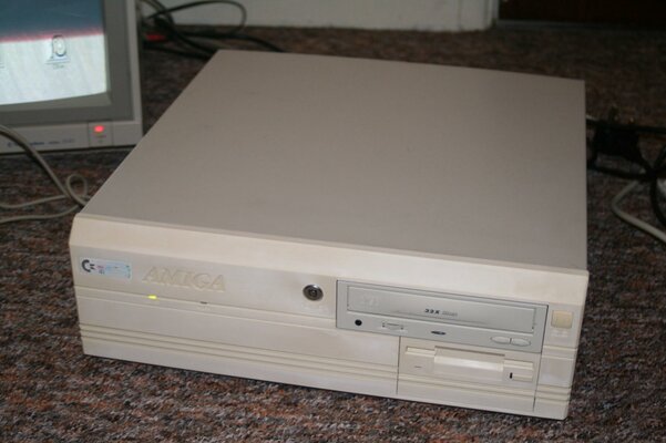

Anagrama dropped off his A4000parts to me for some Retr0bright love. His A4000 machine is prized, as the former owner of his A4000 was none other than Microprose! :wooha:
This is why he wanted his machine restored by an expert in the process and I can fully understand why.

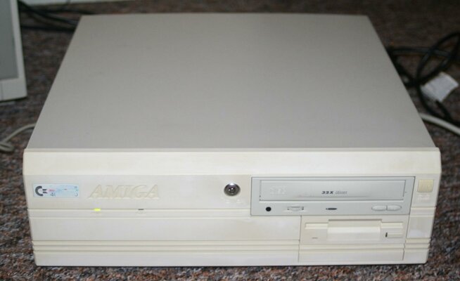

OK, so this is what his parts looked like before I started.
The front fascia looked like it had kidney failure. I set to work and this was the result after about eight hours.
The keyboard was restored but the front wasn't anywhere close. Another eight hours got me to this point:
It's close, but if you look closer, there is still some slight discolouration, particularly in the grooves.
So far, the plastic has shown no signs of 'blooming' at all. My mixture is based on 10% H2O2 with a heaped teaspoonful of Xanthan Gum and one teaspoonful of Glycerine, with 1/4 teaspoonful of Oxy added in. Slow is definitely the way to go with badly discoloured items like the front fascia.
The question for Anagrama (and others that may wish to comment) is this; do I treat the fascia one more time, or leave it as it is?
