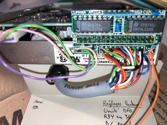

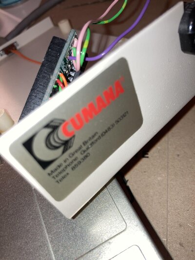

So @darefail, here are the pictures of that external enclosure, from Cumana.
A label underneath says Amiga compatible 3,5' drive 1 MB. I can't remember what was the drive inside when i bought it more than 20 years ago, i think i wanted it to house a HD FB357A drive from the start. No HD working however.

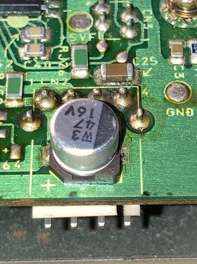

I have cleaned again the FB357A, and it works more or less, but seems to still fail on some disks which are good in the other DD drives i have fixed the days before.
There is a cap about which i don't know what to think (see picture).
Unfortunately, it is the only enclosure i have for the big drives, and most of my spare drives to repair are old Chinon FB354 like in the A2000.

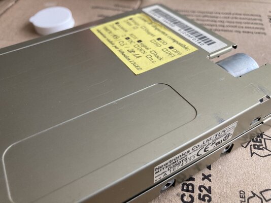

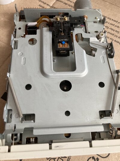

Friday evening, i fixed this one, which seems to be a modified Mistumi drive bearing a label from Sébastien Ligez. He's a french amiga user specialist of floppy drives and he fixed some for me about 12-13 years ago. I seem to remember he made modified drives like this one, but memory is fading, i should have kept a diary.
After cleaning some dust, cleaning the heads, lubing the screw and spraying the sensors, it works good, but there still a little noise when spinning a disk like a small bird flapping wings. I don't know if that is normal for that drive or not.
It happens i have a second one like this which was way more dirty.
After same treatment, i have tried it tonight and it does not work, gives only DF1:??? even without a floppy disk and heads don't move at all even if the disk is spinning. Caps looks weird. What do you think (two last pictures)?

What modification? There is none. The drive i am talking about, that i put into the Cumana enclosure, is a Chinon FB357A which is a regular Amiga HD drive with extra height like in the A2000 3,5' bays. I know it used to work as an internal HD drive, though not tested internally recently. In this enclosure, it works only as a DD drive (with some disks only), an i understood from your previous post that it might work as HD with a modification to the external adapter. Hence the pictures of the adapter. Anyway, it is not perfectly working with all DD disks right now and i shall check this cap later.

About the cumana adapter, it is difficult to understand every line, where it starts and where it ends.
Every adapter is different.
About the cap, I am sure it needs to be replaced. It is 16v 47μf. 25v should be ok too.

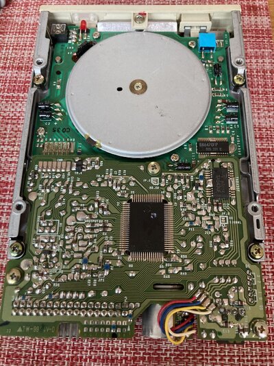

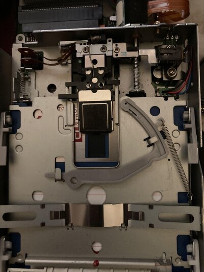

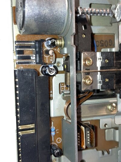

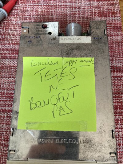

Tonight i have tried to repair this other Mitsumi Amiga drive (not converted so it seems).
It was rather dirty inside. I have done everything like before. Then i noticed the power header was loose and that all four solder joints were dry and broken, so i have attempted to resolder them with my feeble skills, and finally the header seems to hold good.
However, the drive can't read a disk because heads are not moving. Here is a video of the HeadCleaner program which should move the head all the way. It clicks but doesn't move.
So, what could be the problem:
- still bad soldering on the floppy connector (you can see the 4 ugly soldering jobs in the tope left)? Actually, i think i have done well for the two pins at the left, but bad at the two others. Need to redo in plain sunlight.
- dead motor (haven't seen anyone on Youtube dealing with this)?
- bad caps?
It is fun to spend time repairing drives, especially after about 15 years not actually using floppy disks on the Amiga, but it is better to succeed. For now, only 3 and half fixed external drives.

It looks like an Amiga drive.
Check for continuity on the red circle against the positive side of any capacitor near and the black circle against the bottom row of the floppy header, or the negative side of any capacitor or even any screw on the pcb.
I guess you are fine.
Also, I see on the pcb that this drive must have some jumpers on the other side. Are they only for df:x selection?
Thanks!
Yes you are right. Continuity is good between the red circle and another close point corresponding to a cap on the other side of the pcb, and between the black circle and lower row of the floppy header, so i guess soldering job is fine.
There is indeed a jumper on the side of the pcb for DS0 to DS3, currently set to DS0.
I have done some archeology researchs into my emails from 2011, and i discussed with Sébastien at the time about dead TECHNOPLUS drives i bought new old stock, which turned out to have rotten belts we couldn't replace, and he replaced the drives with others, PC modified as i understand. Unfortunately, all my drives have been reshuffled between different enclosure since then and i can't be sure it is this one. Chances are it is because i have another MITRUSMI drive in my second Technoplus casing, which i fixed last week.
I think everyone should keep a detailed registery of his Amiga gear to be sure of what is what when checking decades later.
So, if the heads are not moving, perhaps the motor is dead?
I see 6 capacitors on the pcb. If you can't measure the capacitance, at least measure the voltage while the drive's power connected.
Check for continuity on the switch for disk presence. The drive may not recognise that a disk has been inserted.
Give a twist to the rod of the motor just a bit. Sometimes that helps.
Thanks for your help. I will do that on my next hours of free time and report back.
You can use ATK for you test.
In calibration mode when you press F2 the heads will move to cylinder 40. Also see if the disk in spinning. This way you can confirm that the spindle motor and the motor of the heads are working.
