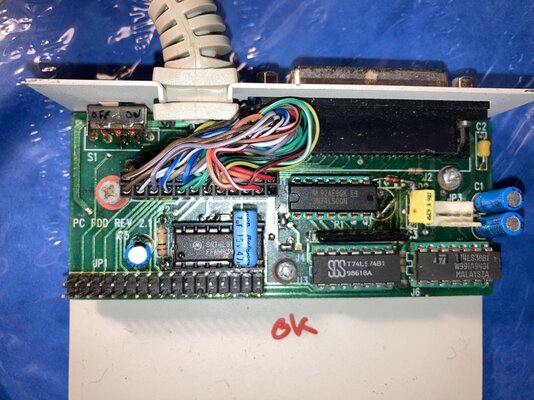

Here are the pics of the board from the Technoplus enclosure (providing of course that the top case matches the lower case, i can't be 100% sure after 25 to 30 years).
I could not remove the board without force to take a picture of the bottom side, so i let it go to avoid breaking it for good.
Any idea what's preventing the heads to move with that board?

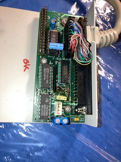

Stupid me, i couldn't remove it, because there was a third screw!
So he is the other side of the board.
With my very limited electronic knowledge and my multimeter, i have noticed that continuity does not check between the legs of that resistor or even between the points there are soldered too. Don't know if that is normal, but perhaps that resistor could be dead?
I have also tested the Omega mode which is believe is related to resistors and i get a fluctuating value but my hands might be too shaky for this small stuff.
EDIT : and i understand now that all these wires are a modification by Sébastien to allow that board to use other drives than the original Citizen with belt which was inside before.
Yet something here is amiss.

This enclosure accepts unmodified pc drives. Have you tried with one?
Ok i will try one tonight.
I only have available one of these slim floppy drive combined with USB memory cards reader but it has a 34 pin header so will try that.
About the continuity around a resistor, as i know nothing, i have asked Gemeni IA and it says there should be continuity with a multimeter. Does that mean the resistor is bad?
Why there should be continuity?
What is the purpose of that resistor if there was continuity?
According to the colors of the resistor, it should be 200KOhm. No way of continuity.
You mean the resistor on your last photo which is between 2 legs of the chip, right?
I don't know, i have asked the IA and it seems as clueless as i am.
Yes that one.

In the meantime, here is the board from the last enclosure not working apart from the Technoplus. This one is Roctec RF302C. All drive tested with this one gives DFx:??? without any floppy disk.
Under artificial light, i thought that some pins of the HD7438P chip might lack solder but continuity check (again!) seems good with my multimeter.
Any idea what might be the problem here?

Check the continuity of the switch to make sure it is working as expected. The switch normally enable/disable the drive.
I would recommend using Amiga Test Kit to help troubleshoot and diagnose floppy disk drive issues.
