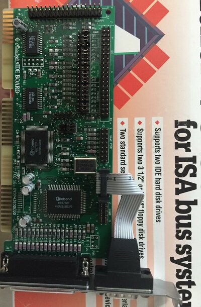

Make sure your floppy controller is configured to 3F0h. I don't remember what error 2h means. I need to find the error codes. Do you have more multi I/O controllers to test? I remember having a similar problem that was solved by using a different controller.
Can you upload a picture of your 16bit multi I/O controller?
OK, let's try something. You seem to have the floppy controller set to port 370h. Please set JP3 to 1-2 position. On the picture JP3 is set to 2-3. The HD floppy BIOS extensions in the card i sent to you are set to port 3F0h. If you set the JP3 jumper on the 16 bit card to 1-2 position the card will be set to 3F0h. Try this please.
Also it might be a good idea to remove the 386 board and test it at least once. But try setting the JP3 jumper on the floppy controller to 1-2 positions first. You might also leave it there from now on. That's the position it should be on anyway if you only have 1 floppy controller.

Actually, JP3 was set to pins 1+2 closed (3F0h) and when I changed it to pins 2+3 (370h) I got no drive activity at all on boot. I did try an alternate 3.5" 1.44MB drive and a new floppy cable - made no difference. So odd that I can boot off of the drive at 720K and the 1.2MB drive is working. I'm stumped.

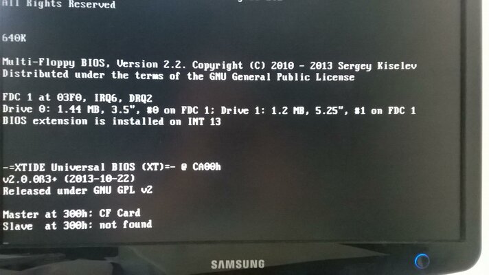

For some reason the HD Floppy BIOS i sent you does not seem to be working on your system, despite working perfectly on my XT clone with a similar setup (also using a 16bit controller). The reason you can boot from a 720k and 1.2MB floppies is because the 86 system BIOS in the IBM 5160 already had support for both 720k and 1.2MB. But because the HD Floppy extensions on the card i sent don't seem to be working you can't get 1.44MB support at all.
The picture above is your card on my XT clone. Do you see the Multi floppy BIOS message on your system like on the picture above?
