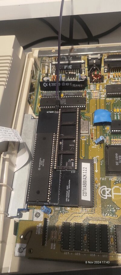

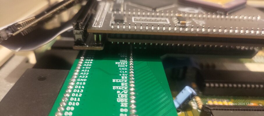

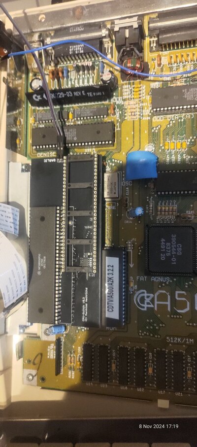

@Vaderqrt this works like a charm, I soldered a Rugged old 68K CPU in, the 68K had a lots of bent pins so I was happy to straighten the pins the best I could and solder it
Jumper off = TF536 on
Jumper on = 68000 on
Obviously shutting down the Amiga before switching over CPU's
Just got to sort out a suitable switch and add a rom switcher to switch from Kickstart 1.3 for the 68000 and Kickstart 3.2.2 for the TF536.
I am using a right angle CPU relocator for the TF536 to ensure its as far away as possible from the Keyboard
I've added pictures I am using a CDTV version of the TF536 which will but it in a different position than a normal TF536 i just haven't got around to ungrading the firmware or the normal TF536 I have to a CDTV firmware to work with my A570

I am curious to see how it will prove reliable when there is some sandwiching with relocator, riser and turbo card. I got a lot of troubles before with too much parts stacked.

@Xanxi dont know how I forgot to post this picture
