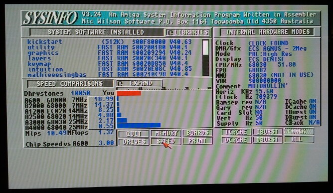

So, I closed S7 and switched on my GBA... Hummm... how I could say...YEEEEESSSSSSSSSS, the workbench is launched with 2M of Chip Ram and 8M of Fast Ram! Actually in 24Bit space. I change to 32Bit tomorrow, now dodo... sorry... go to sleep! :)
Yes, but I had also a problem with the CPU Clock. (13.40MHz instead of 50MHz) And, perhaps it's just a sensation, but the system is launched really faster.
Hop, test with SYSINFO... TADAAAAAAA! 51.80MHz! It's stange no?! S7 opened: 13.40MHz.... S7 closed: 51.80MHz... Somebody can test onto his GBA to see if it's the same result?
SYSINFO screen here:
SO, piacc64, MEGA Thanks! I was really stuck! :thumbsup::thumbsup::thumbsup:

my board work at 40mhz and without fastram sysinfo report 12.90mhz
same with a1200 with 1230 without fastram, is a bug of sysinfo

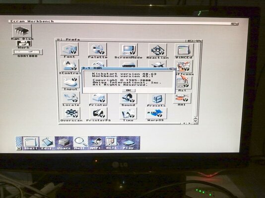

Just for fun... My GBA1000 under Workbench 3.9! :)
Cool, but really need a graphic board!!
