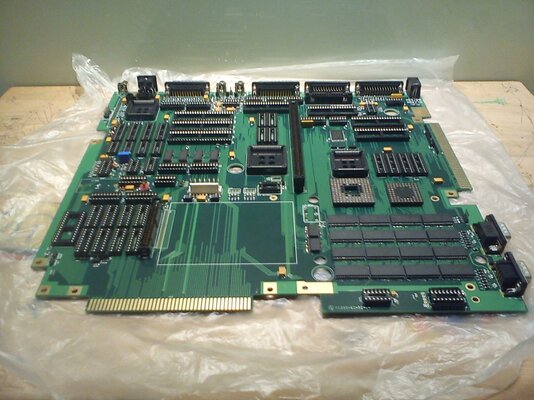

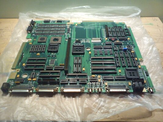

Well, my GBA1000 is almost finished!
I have ordered the two power 4 pin connectors and the 44pin ide one.
What I need now?
- Two kits of video hybrid modules from Kipper2k. I hope he will receive the pcbs very soon!
- A confirmation about the cpu oscillator:
Actually, I have a 50MHz oscillator. If I have well understood, and if I want to use it,
I have to solder R122. R135 and IC78 aren't not be soldered. Am I right?!
Photo joined!
