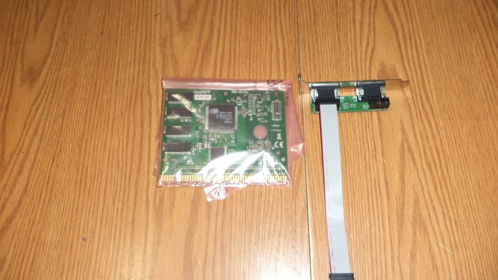

Hi chaps,
Description of the installation given by user britlord is totally wrong!
To let this card work You go as follows:
1. Install Picasso96 (choose Piccolo64SD Card from list, as this card is using same graphic chip)
2. Copy patched files from Matzes archive over installed files
3. Copy gbap2+.info to Monitors folder and delete other monitor settings.
Have built and installed at least five cards in this manner - works like a charm without any registration :thumbsup:

Thanks... Though Matzes did want to supply the P96 RTG software for his board (He said so)... But wasn't able to due to copyright then (I know the guy very well)...
Read the first thread (Though must have changed since then)...
https://www.amibay.com/showthread.p...APII-ZorroII-Graphics-card&highlight=GBAPII++
