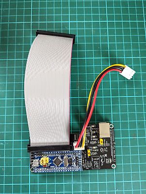

Also the Greaseweazle is a nice cheap alternative
