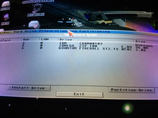

For Merlin and mousehouse: I put in a refurbished IBM SCSI CDROM unit that I received yesterday, with a terminator. I also put a valid CD disk, as well as a valid Iomega disc. There was no icon on my WB screen (Picasso image with USS Enterprise facsimile). Went into HD toolbox and am sending the attached image showing the Amiga 3000 recognizes the CD drive, but no icon of the drive. <strong>What is my next step? Thanks! Also yesterday, I finally got my KS 3.1 ROMs for the 1200 and with the help of Jack Calk on messenger, got it up and running with a WB 3.1 on a 4 GB compact flash card.

Mousehouse is right - you'll need some drivers to see the ISO9660 CD file system and then you should see CD0: on the screen. You're getting there! The hardware side is sorted now.

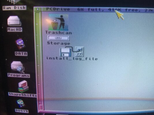

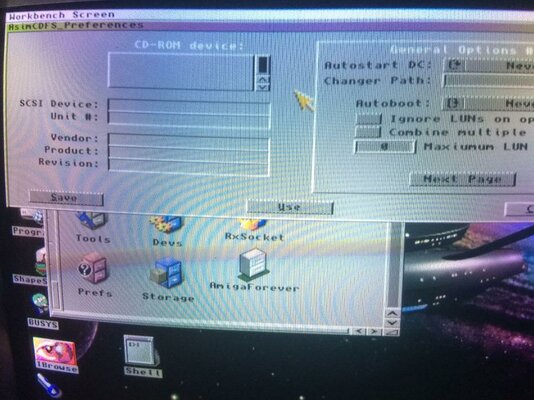

You would need to install a filesystem for the CDROM to start with. Did you manage to do that? Depending on which version you used you might need to set the correct SCSI ID in the tooltypes of the icon in DEVS. Same goes for the two files I shared for the Zip drive (put them in DEVS DOSDrivers). Then edit the tooltypes (click the icon once and select "Information" in the workbench menu) and set the correct SCSI device and SCSI ID.

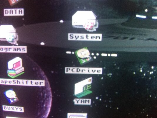

I'm sending screen shots (out of ignorance) to show what I've got. Opening the PC Drive icon gives the 4th icon, and the other two, 2 and 3 are from ASIMCDFS. I still need to know how to use the links mousehouse gave me for Iomega icons, which are on my laptop. I believe I have OS 3.5 on my A3000, at least I have the official Amiga CD for OS 3.5
