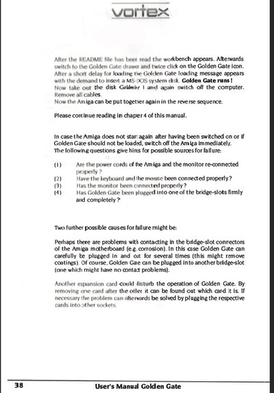

Thanks to Niezgodka who has lent me his manual, I have been working on scanning the English portion. 2 things to note, the manual has seen better days (Not a complaint at all) and my scanner seems to be adding some weird light blurring, but all in all it is readable. Any suggestions on where to upload this once completed?
The blurring looks like your scanner could do with a clean. The blurring is from oil on the glass . USE GLASS CLEANER not a bleach or multi surface spray , if you have glasses and use a spray or wipes for those they would be excellent!!:D
That is the issue, it isn't the glass. I cleaned it with glass cleaner and it isn't the glass. Its a cheap multifunction printer and I think it just sucks. I have cleaned the glass and re tried on several pages and I cannot correct it.
- - - Updated - - -
In reading up it would appear perhaps it is from external light getting in, since the book is thick the scanner cannot close all the way.
yes that would do it , lay a towel ,or something fairly thick over the top before scanning to cut down the incident lighting.
