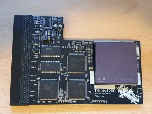

Saw there was one in stock so grabbed it as a Christmas present to myself and also got a Rev6 060 from @screemo (Thanks!)
Both arrived before Christmas which was a surprise given how Royal Snail are during silly season!

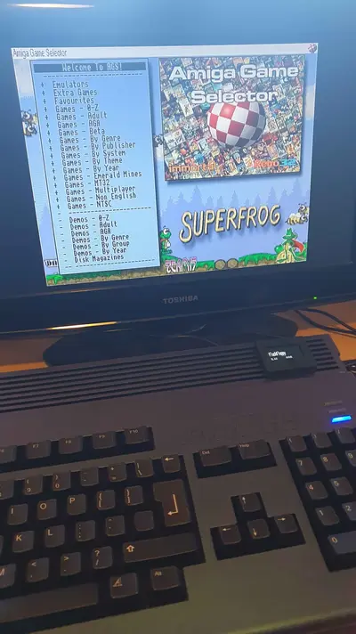

Haven't done any extensive testing yet, just set it up and booted with AGS to make sure it runs, seems to stay pretty cool at 66mhz, after using it for around 40 mins or so various things from Doom to Gloom it measured around 45c (case closed)
Need to fiddle with one of my old 3.9 builds and get it setup with the 16bit sound, etc.

Well the main thing is it has 16bit Audio on board so you can setup via AHI and enjoy games and software which support AHI
I did have a TF1260 but it was quite unreliable, I never got to the bottom of the issue it seemed like it was just connectivity related and in the end I got fed up and got rid. (Note this was one I got from eBay and not from our resident expert Supaduper) Long storey short I wanted a black PCB to match my Motherboard hence buying elsewhere.
I'm hoping the Trinity will be better, all good so far but have not tried to OC beyond 66mhz yet. In the meantime I have been using a TF1230 which has been great for WHDload but I did miss the 060 power.

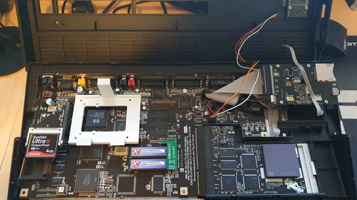

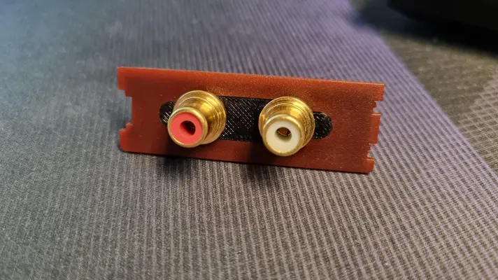

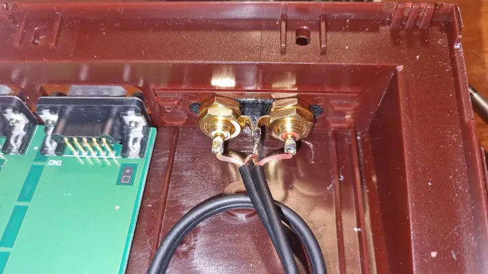

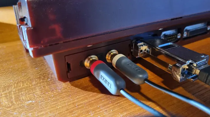

Got one of these cards my self. I like that it also provides a native audio passthrough, making it possible to use one cable. There is one caveat, and that is the register controlling the passthrough has to be set. Normally this is done by the Trinity software when Workbench starts. If starting the computer without a startup-sequence, this can still be done by manually typing in the register value in the DOS shell.
Ended up soldering a 3 pin header on the card and fabricating my own connector-cable assembly for the audio. Was challenging to find something that would fit the 3.5mm audio jack on the card. Two RCA connectors are mounted in the rear expansion bay cover. Got an A1200net case and 3D-printed an adapter piece for one of the provided covers that have a DVI(?) mounting hole.

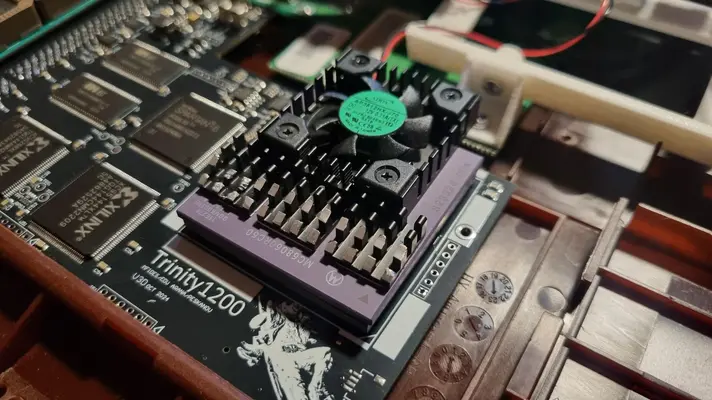

Did you put a heatsink on the CPU? I need to find one that won't conflict with the keyboard.

No, I don't think I'll overclock tbh so the Rev6 should be fine without

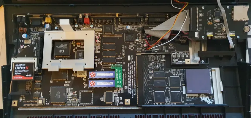

I did fit a fan since I sometimes overclock. I believe I got this fan along with some tiny passive heat sinks. The fan assembly has to be mounted offset since it collides with the keyboard. The passive heat sinks were filed down to clear the keyboard.
Here are some pictures of the audio installation. Couldn't find one of the header, but it is regular 2.54mm pins and crimps.

About the audio connection, it seems some people had mechanical problems to use the onboard jack. But Edu told me that the sound output can also be taken out from J4 as L-G-R, so it is possible to solder a cable and a jack somewhere else if needed.

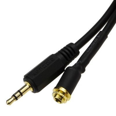

I don't think the cable will fit. I initially tried a 3.5mm straight cable but it collided with the motherboard/case. An angled male jack is most likely needed.
I opted for the 3 pin header and applied socket crimps and a socket housing to the cable that goes out the back. As Xanxi mentioned, it goes on the J4 location near the audio connector.

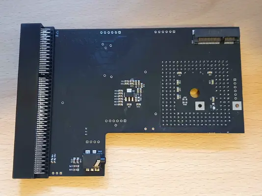

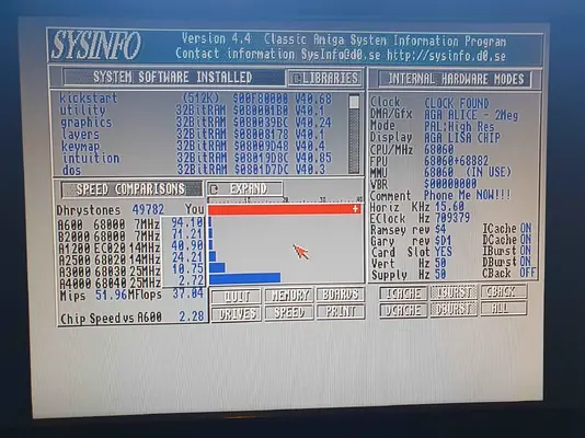

Setup a proper workbench now and did some quick tests with Quake 1 and 2, they run very nice indeed, I think maybe better than my old TF1260 and Blizzards.
Quake 1 was CPU=66mhz and Quake 2 was CPU=80mhz
Amiga did not boot at CPU=100mhz (not that I would ever run it this fast anyway 80mhz seems fast enough and I don't have cooling yet!)
Bought a small angle 3.5mm jack, still doesn't fit. What a stupid design to put it in the one place you wouldn't be able to plug anything in lol
I don't really want to solder anything so I'm a bit stumped how to use the audio 😒
